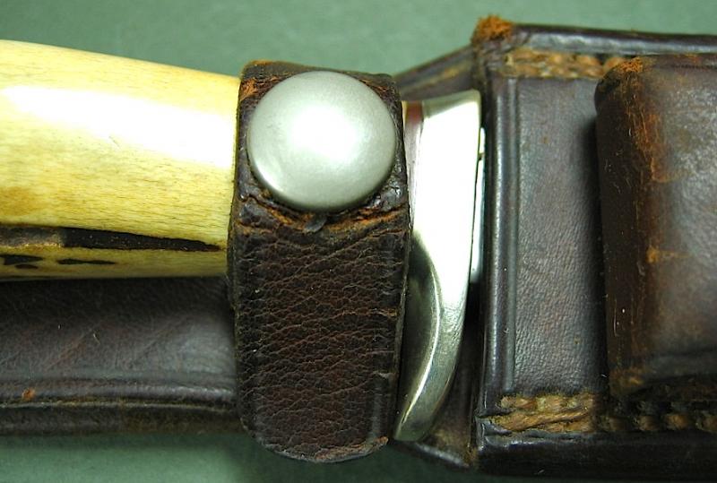

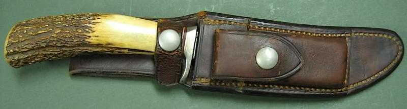

Neatsfoot oil is death to leathers you wish to preserve. My dad believed it was good for everything, and treated this Randall knife sheath with it about 35 to 40 years ago. Today the sheath is very black and the leather is coming apart. The leather around the snap has almost completely deteriorated, and the rest is soft and flaky. The sheath was one of the old Johnson sheaths which were a beautiful light russet when new.
