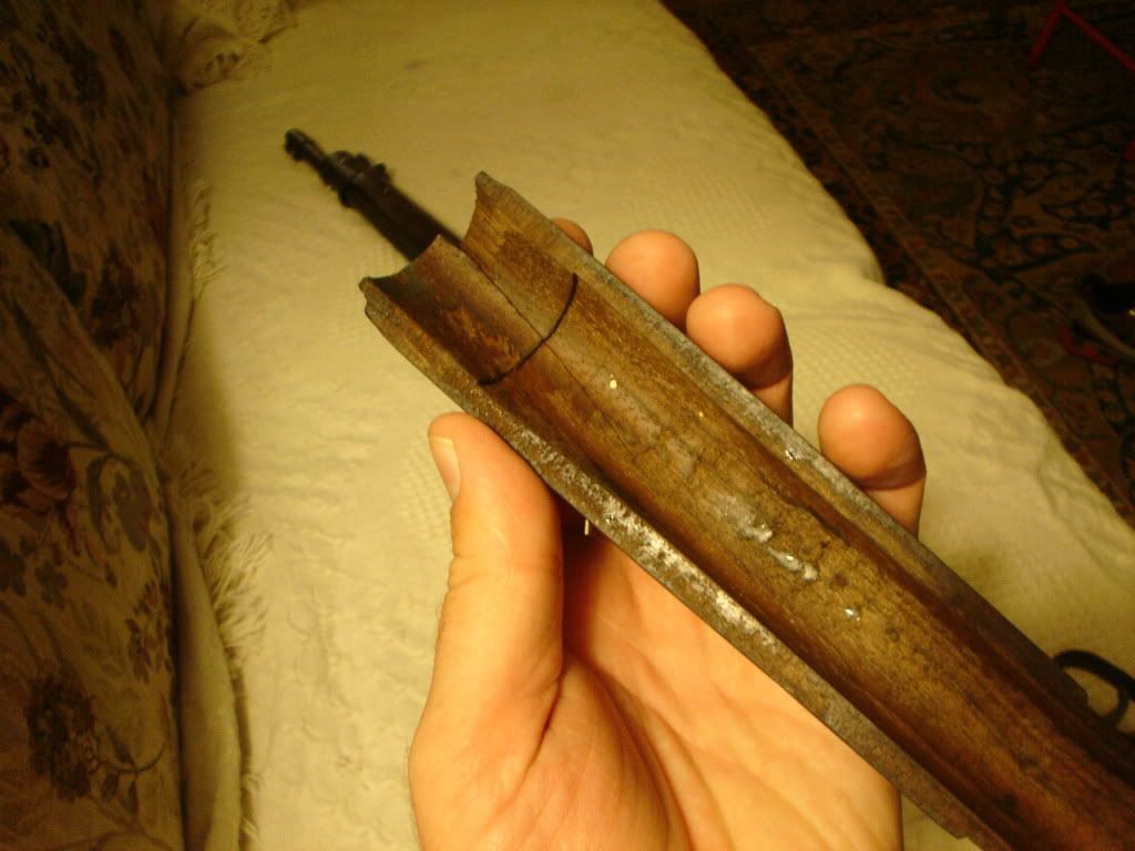

I actually asked for the type of upperhandguard in an earlier post. This was due to the condition of the current one. It has a crack in it. I suppose I could repair it, but would rather replace due to the apparent low cost of this item.

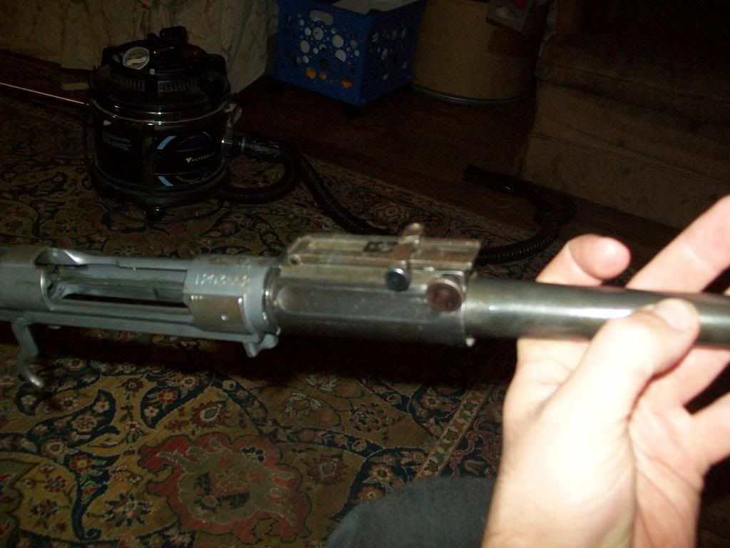

First photo is of the barrel loosely mounted to the receiver:

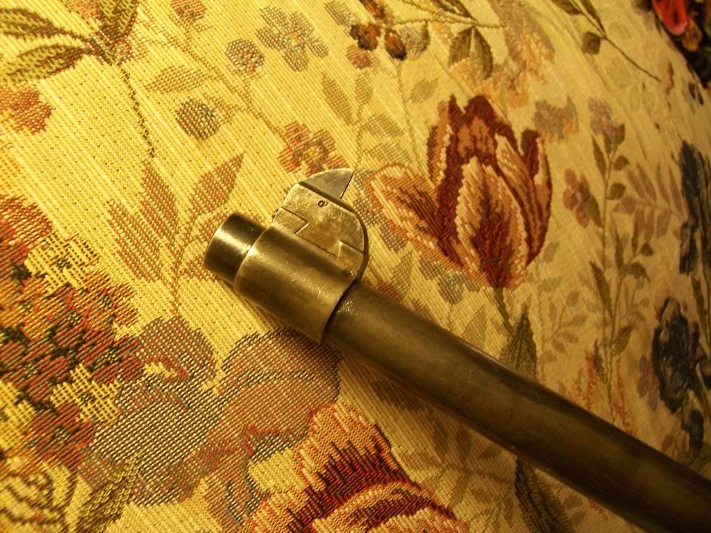

Next photo is of the front sight on the "new" barrel:

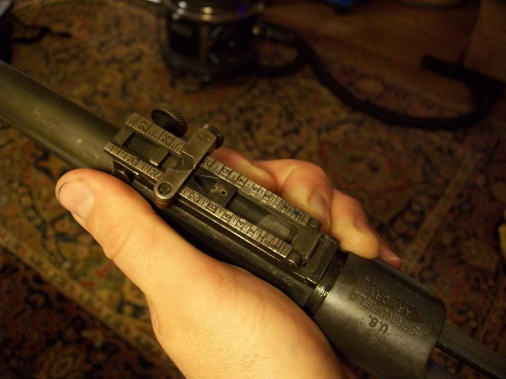

This is a view of the rear sight on the barrel:

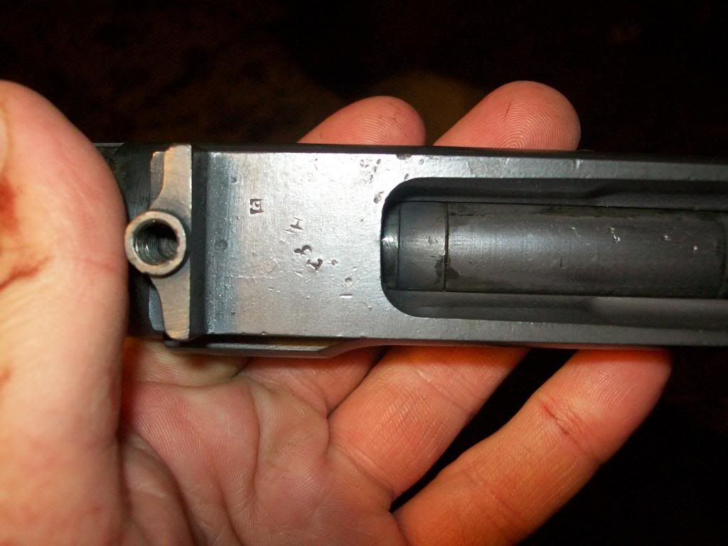

Next photo is for the experts... I can't seem to get the shot right, but I have included it in tonights upload:
I tried to get less glare, and also used white out to get the markings more clear. I found these after turning off the barrel.
I think one marking on the face of the receiver says: J73 this is towards my finger nail. The second I believe is: D, which is towards my finger joint. Additional proof or heat codes?

"J 73" is the receiver steel lot code.
I'm not sure what the "D" is.
Hope this helps. Thanks for posting the code.
