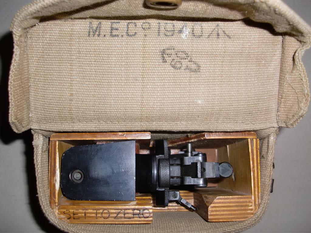

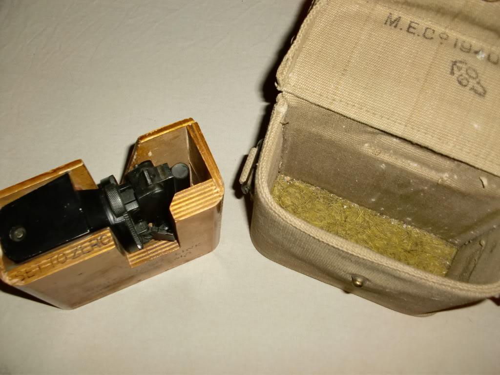

Thats a new one on me too. As far as I know, the bino case was the only carrier (in conjustion with the special FLS insert). Perhaps there is another part to be found!
I wonder if there was a lined FLS case, similar to the standard bino case. In much the same way as the lined compass pouch that was identical(?) to the pistol ammo pouch except for being felt lined.
Having said that, the FLS frame is a tight fit into the normal bino case
https://www.milsurps.com/images/impo...CIMG1569-1.jpg
https://www.milsurps.com/images/impo...CIMG1568-1.jpg
Not much room for padding on mine.

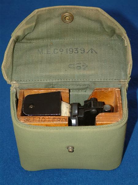

I'm presuming that by the correct bino case you mean that 39 period dated to the FLS the bino cases would not have had the side buckles ?
https://www.milsurps.com/images/impo.../flsbino-1.jpg

Picture of a the two attached. I think I have another FL number for you as well.Just have to find it ..
Attachment 19411Attachment 19412
Yes, but it's still a bino case Wheaty, albeit a 1939 bino case worn on the belt!
Peter: The case without the buckles is a 37 Pattern case .....It appears most were used for the FL sight as they did not have the side buckles....
