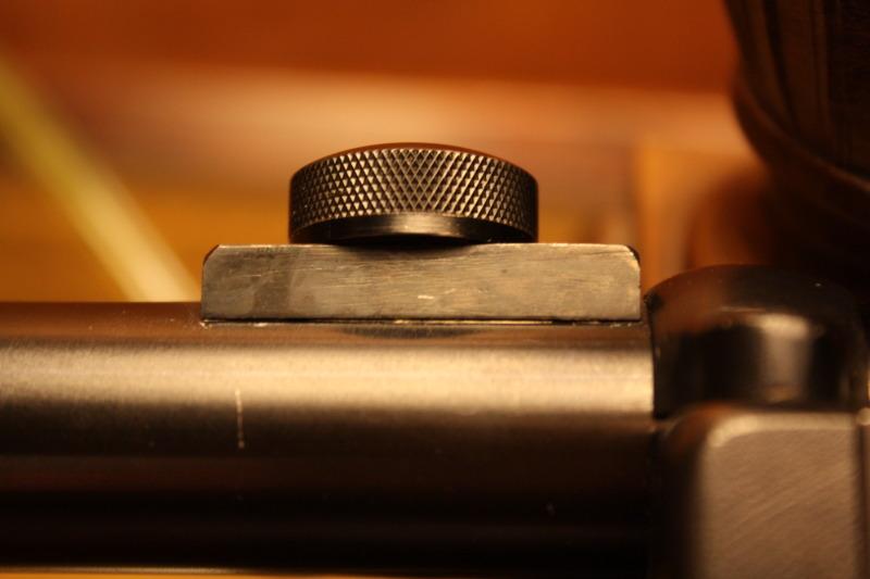

The one photograph you did not show is one of the scope elevation turret. If the scope is kosher it will have a number starting with a 4 and ending with the letter S. The rear sight is correct for a sniper with the "Maltese cross" on it and the markings seem good from what I can see at a quick glance. The only fly in the ointment with the serial number, as I mentioned in a previous post is the 74L are not the same as the numbers following the prefix. A most interesting rifle and while the scope and rifle may not be one unit they both seem kosher but as to when and how they came together is a mystery. I do know that some were made up by the military well after the war, so take it from there.......
This is the second one like this to surface in the last while......

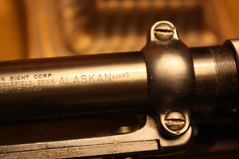

Good catch W. The scope, numbered 4498S, falls into the correct batch for a TP, but there are no markings at all on any of the turrets. Not even the "All-Weather" found on the commercial variants. Here is your pic.
https://www.milsurps.com/images/impo...IMG_3026-1.jpg
Ian
The scope if numbered on the elevation turret, left side is a good one. A genuine Canadian purchase 32TP and not just a Lyman Alaskan as some have turned out to be.
The 32TP did not have ALL WEATHER on it.
Where is your scope numbered 4498S ???
Just to the right of the "ALASKAN" on the scope, as shown in the pics. The numbers are canted at an upward angle and are of smaller, different font. The pic is dark so here is another..
https://www.milsurps.com/images/impo...IMG_3034-1.jpg
