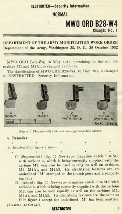

The Carbine Club Newsletter (years ago) had an article on an Army Division in Europe, during the war, upgrading 5,000 carbines with Adjustable Sights. I do not remember the details.
https://www.milsurps.com/images/impo...magcatch-1.jpg

Maybe you'll find info on postwar carbine rebuilds there. Please let me hear thru email or PM. Good luck and thanks.
