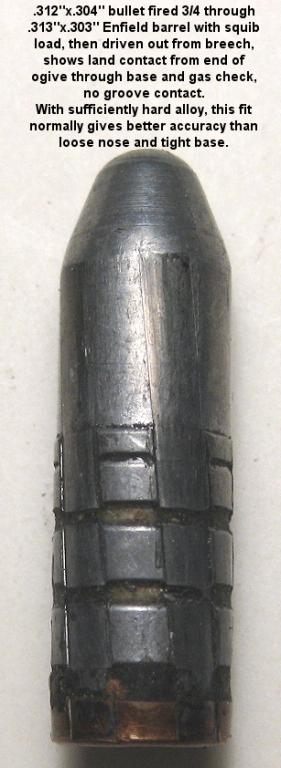

Unless you're shooting cast bullets, there's relatively little to be gained by learning your .303's internal dimensions. Well-constructed jacketed bullets often shoot well in barrels with groove diameters significantly larger than the bullet, the jacket being stiff enough to align bullet with bore axis despite some clearance in the grooves. When bore diameter is so large that the bullet is engraved only lightly by the lands, even stiff-jacketed bullets may yaw in the barrel and fly erratically - but this is a fairly uncommon situation.
Lead-core copper-jacketed bullets up to about 1% (.003" in a .303) larger than groove diameter can also function and group well, although caution is required to ensure adequate neck clearance in the chamber and to work up loads carefully to avoid unexpected high pressure from added resistance as bullet enters barrel.
With cast lead-alloy bullets, too soft to resist off-axis deformation when not carefully fitted to throat and barrel, knowing the relevant dimensions is critical to selecting moulds and sizing dies. Choosing the wrong mould and/or sizer can be a costly error that is avoidable by careful measurement before purchase. Ideally, a cast bullet will provide full land contact through most of its length as well as groove contact on its driving bands and minimal clearance in the throat.
https://www.milsurps.com/images/impo...0/vpdoc1-1.jpg
Slugging a barrel does not have to be a one shot deal.
A slug pushed all the way through can find the tightest spot.
You can also push a slug through to find the loosest spot, then push another slug in from the other direction if needed to slug the loosest place.
So how about the hypothetical loose spot between two tighter areas? That may be a hint you need to lap the tight spots a little just like custom barrel manufacturers do to make the bore more consistent.
