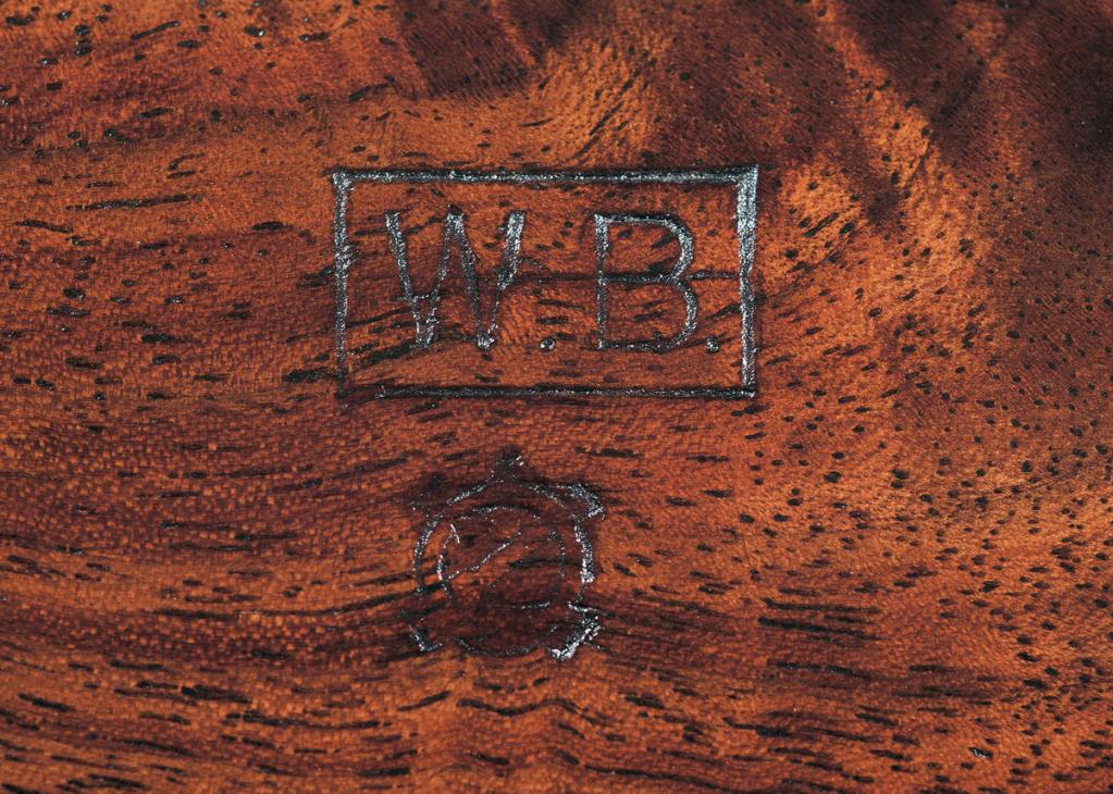

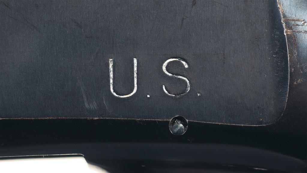

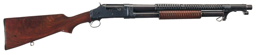

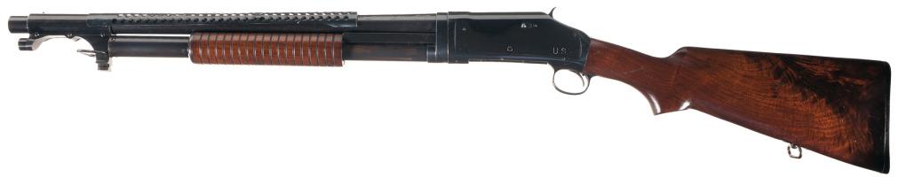

A different subject.
The gun shown below is a W.B accepted gun that sold at RIA in 2011 for $8,624 in Sept 2011.....big bucks.
https://www.milsurps.com/images/impo...mber2011-1.jpg
https://www.milsurps.com/images/impo...Sept2011-1.jpg
The description is below.
Winchester Model 1897 Trench Gun manufactured in 1942. This take-down M1897 Trench Gun has the scarce and very desirable early WWII production features that include: (1) WWI style, six-hole hand guard/bayonet mount, (2) early pattern markings with "U.S." only on the left side of the receiver and (3) early Ordnance final inspection mark consisting of "W.B." in a rectangle above the small Ordnance Escutcheon on the left side of the stock. A small Ordnance 'Shell and Flame' inspection mark is stamped on the top of the barrel just ahead of the receiver. The shotgun has the Winchester commercial blue finish on the hand guard, barrel, magazine and receiver. The walnut stock and forearm have a dull varnish finish. The stock is fitted with a black, checkered, hard rubber, buttplate embossed with the round Winchester trademark and a sling swivel. The hand guard is fitted with the correct wire sling swivel above the bayonet lug. The underside of the barrel is stamped with the "42" (1942) production date. The left side of the barrel is stamped with the two-line legend: "MODEL-97-WINCHESTER-12 GA./-TRADE MARK-". "23/4 CHAMB./CYL." is stamped on the left side of the barrel between the Winchester legend and the receiver. The oval "WP" monogram/proof mark is stamped on the top of the barrel and the receiver. The serial number: "937039" is stamped on the underside of the barrel and "E/937039" is stamped on the underside of the receiver. The hand guard/bayonet lug is, correctly, not marked. Most WWII production Winchester M1897 Trench Guns were fitted with the later production, four-hole, hand guard/bayonet lug. These Trench Guns had the later style markings which consisted of "US" and the Ordnance "Shell and Flame' insignia on the left side of the receiver and "G.H.D" final inspection above the larger Ordnance Escutcheon on the left side of the stock. Winchester Model 1897 Trench Guns, like this one, with the early hand guard and markings are scarce and very desirable.Condition:Excellent. The Trench Gun retains 95% of the original blue finish. Wear is limited to light scratches and storage marks on the sides of the receiver and some minor cycling marks on the magazine tube. The stock is highly figured walnut and is in excellent condition. The Ordnance inspection marks are crisp. Wear is limited to a minor scratch on the left side of the pistol grip. The forearm is in excellent condition. Winchester Model 1897 Trench Guns saw extensive use in the Pacific Theater during WWII and remained in service until well after the Vietnam Conflict. As a result, examples of M1897 Trench Guns in original condition are scarce; early production M1897 Trench Guns like this example are very difficult to find with any amount of original finish.
The description is right on. That is amazing money. Of course, you need to examine the gun or have good closeup pictures to determine if there is anything funky about it. At that price level, it would pay to make a good fake.
The picture looks really good but is not detailed enough to make a real evaluation.
The WB mark, no bomb and 6 row is correct. In that range, a GHD mark can also be correct, the change of inspectors and change to 4 row happened at about the same time. And you will find some lower numbers that have the bomb on the receiver. There is a small amount of mix and match in this serial range.
That is a durn nice looking shotgun. Well bought!
I saw 2 that nice at the Antique Gun Show in Las Vegas last weekend; $6000 each.
