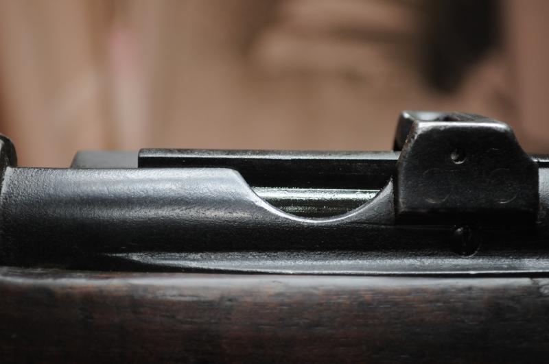

well I took some pictures of the bolt in the receiver showing the gaps and trying to depict the play I'm experiencing
1. Gap between that rail and bolt.

I found the reason for the magazine modification, it does affect the closing of the bolt that being said I think its safe to say this rifle while looking nice is completely pooched.
