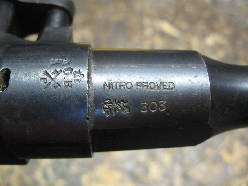

Going by the between the wars London "Military" Proof mark, it is unlikely that it ever had a volley sight.
Printable View
Beerhunter,
What London proof mark are you referring to?
The photos are too blurry for me to recognize any of the marks with certainty, but your eyes might be better than mine. Can the owner try to post a few pics using the macro feature on the camera?
The only evidence I can see that this might be a commercial/trade rifle is the lack of a date and model model number on the butt socket. Directly contradicting that identification are all the government marks, including the royal cipher. We shouldn't take the barrel as evidence, because it could have been fitted later (by AG Parker).
Close-up, in-focus pics of the RHS butt socket and LHS of action that show the stamps might settle this mystery.
Cheers

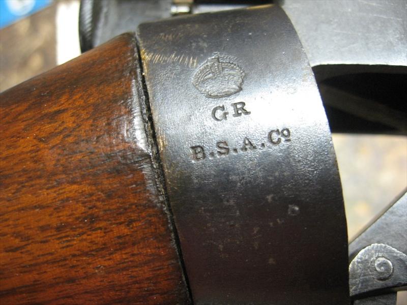

I have some more pictures on my photobucket account. Basket Case pictures by Cdn303 - Photobucket I can't take anymore right now b/c the batteries in my camera are dead and the stores will be closed till Saturday, being Easter and all. The RH butt socket only has the crown over GR and B.S.A. CO. Please note that the pictures are all pre-cleaning.

As promised, here are some better pictures of the RH wrist and LH knox form

The remains of a nice commercial No.1 target rifle. Would that be a Central sight base it had with those screws? Looks like it to me.
I'm with Beerhunter on this one. It's interesting because it doesn't sport the usual BSA military markings but looks like a "commercial" that was inducted for military service during production. I had 20 of the Bahrain purchase rifles and they are marked as "BSA Co." commercials sans the Royal Cipher. I've been in the repair shop this weekend cleaning up the last four of them so I can post them on the website, (which is way overdue). These inter-war rifles were what I refer to as intermediate Mk.III with the cut offs present but no provision for the volley fire sights. It's hard to tell when they were manufactured because they aren't dated.
Nice project, good find. I've got an AGP Parker Hale almost like this, in full wood. The right wrist markings are only BSA Co, there's no cipher. Its estimated to be early 1920's. It has the cut off, and no volley sights. It has the PH5a sight, which I think is more correct than the plus 5. The 5a's seem to be the commercial choice after the 1920's, and in my opinion others like the Plus 5 would have been an individual owners choice after buying the rifle. The Plus 5 was a design that was superceded with something better, so its reign for serious shooters was not too long.
The screw head reminds me of a Central with its squarish look but the diameter looks smaller, more like the PH5a one I have on the rifle here, narrower screw heads that are a bit taller in the head are what I find on earlier sights like the plus 5..
