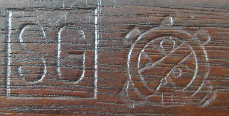

Makes me sick to tell you that, but I'm positive about the SG stamp.
CC also would have to be questioned. Though it's just a partial stamp (More than likely struck lightly intentionally) The Flame lick doesn't match up to known originals.
I'll post a couple pictures here, some I own, and some from friends to compare.

Charlie- Thanks for your input- I'm in conversation with the seller now and I hesitate to name him until things get further along- I am happy with the carbine itself but of course not so with the stock- Could you be more specific about the reasons you feel the stamps are not legitimate so that I have more ammo so to speak with the seller- Thanks a bunch
T-C,

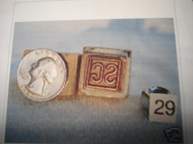

The G on your stock is very much like the earlier fake/reproduction stamps we were seeing being offered on Ebay.
Latest batches have improved.
Your best proof is using the pictures I posted of real SG stamped stocks.
Here's another faked SG stamped carbine stock.
Different style SG stamp used than your's but still a fake.

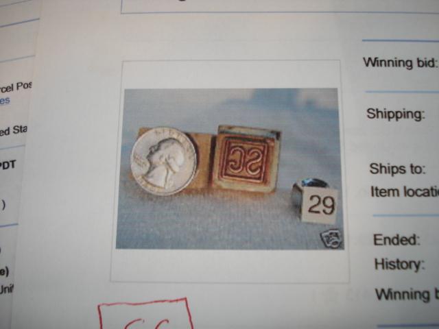

I'll post a picture of a very similiar SG stamp from Ebay.
GB Auction....
M1 Carbine - Saginaw Gear (SG) w/H/W Stock : Curios & Relics at GunBroker.com

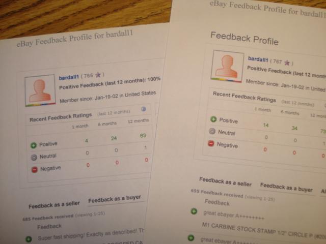

Here are Fake Stamps and one of many sellers....
m1 carbine stamp | eBay
eBay Feedback Profile for bardall1

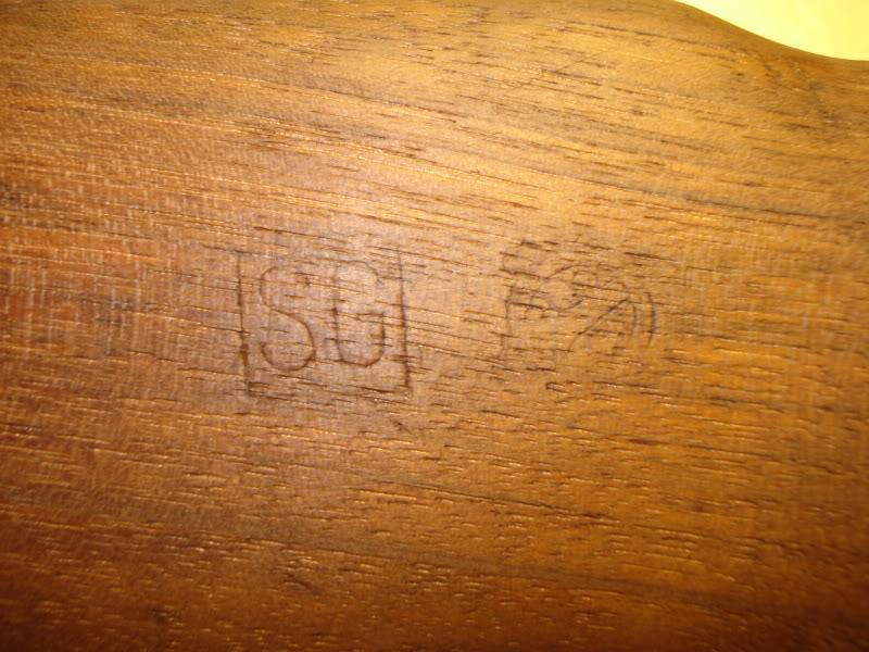

I just got around to taking pics of my new Saginaw carbine. I am kind of confused regarding the stamp in the slingwell, and I would love to hear your opinion:
Serial is ~3.37M. All other parts seem to be original. I attached two pics, one of the stamp in the slingwell and one of the cartouches. Fake/real, what's going on and what is the number 39A? I only found one reference on the number, and it is (?) an indication of lateral support from Inland. Any clues?
Beginner,
Real.
Right side SG boxed and crossed cannons is the primary contractor who received and assembled the carbine. Markings in slingwell in the manufacturer of the stock, but the 39A was added by Saginaw.

Saginaw Gear did get some stock from Inland and your stock is one of those. Should have the oval oiler slot. You have a nice one for sure.
