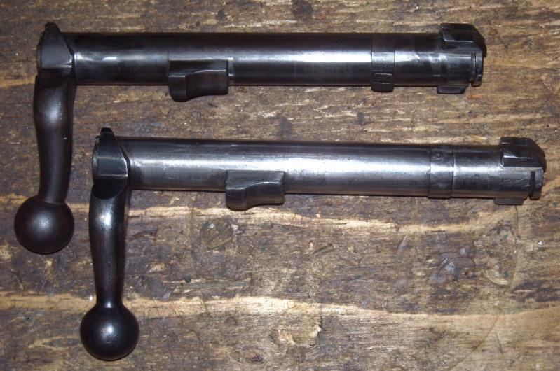

I have access to a new-looking straight-handle early 03 bolt. I'm assuming this would not be ideal though as it's likely a SHT bolt or period-incorrect for a refurb. No obvious heat code on the bolt root. looks to be rust-blued, not parkerized. Anyone able to ID it?
Bottom bolt in this photo.
https://www.milsurps.com/images/impo...DSCN3680-1.jpg
Someone has chemically removed the blueing on the bolt body, only the handle is still rust blued (I could re-blue it if it's a worthwhile bolt to use).

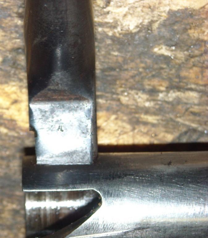

Only marking is what looks like a capital "A" under the bolt handle:
https://www.milsurps.com/images/impo...DSCN3681-1.jpg
This doesn't appear to be in the heat code charts, so no idea on an ID???

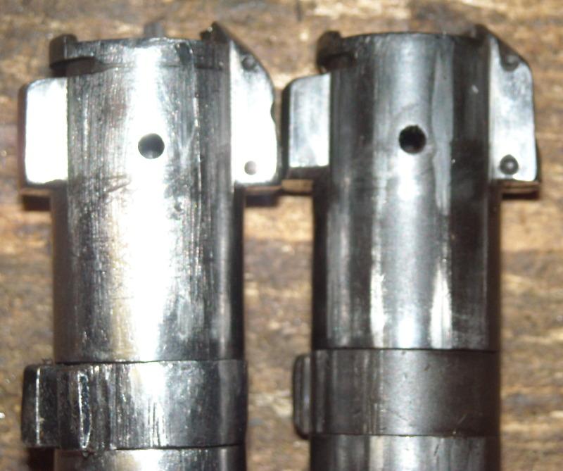

Underside compared to my other bolt (this new bolt on the left). Both are single-hole.
https://www.milsurps.com/images/impo...DSCN3682-1.jpg

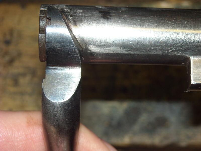

Noting on the bolt ledge.
https://www.milsurps.com/images/impo...DSCN3673-1.jpg

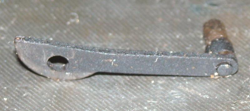

By the way, out of curiosity - what purpose does the little flat spring and peg do? I mean the little one that fits in a slot inside the receiver magwell near the back of the magazine?
This is the part I am talking about:
https://www.milsurps.com/images/impo...DSCN3684-1.jpg
That is the bolt stop. The "peg" protrudes through the receiver rail and catches a corresponding detent in the left lug of the bolt. If the rifle is pointed down, this should hold the bolt back for reloading.
The bolt stop and detent in the bolt were done away with during Rem '03 production, I believe.

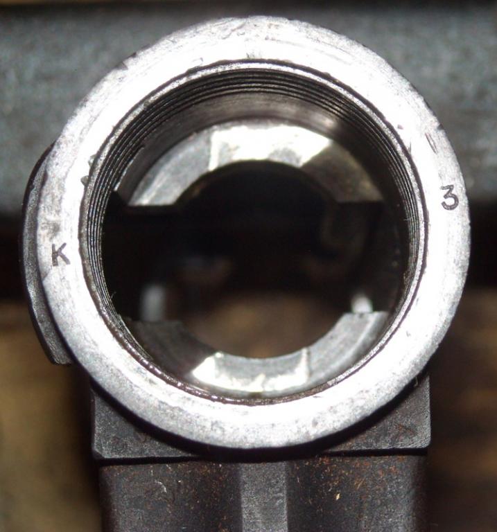

Also, I got the bbl off my SA low-number receiver. Very little set-back in the recesses and the receiver came off without any fuss. I sure wish there was an obvious way to know if the receiver forging was "burnt" or not...
https://www.milsurps.com/images/impo...DSCN3679-1.jpg
Low number aside, it's actually a nice receiver with minimal wear, no major condition issues, etc.
