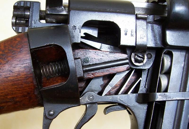

Had the rifle at work today, couldn't get the plate out but here is the photo of my other 1935 Lithgow

This is what it looks like removed from the forend.
I can see that the mechanism is another means to achieve an end but is it a commercial means of tightening up the fore-end to achieve greater accuracy or a military idea to save patching the draws? Any Military input at all?
Just another Q following on from RJW (#16 below.....). Are the rods adjustable in any way? It doesn't look like it but by definition they MUST be due to the fact that every rifle is slightly different - that's why we have to FIT a fore-end!
I like what I see, although it could be upgraded to really do the job, overall, a must try for the target shooter, otherwise I'm with Peter's question, inquiring minds need to know.
No adjustment on them, i would think they have to be fitted.
The answer to your Q "is it a commercial means of tightening up the fore-end to achieve greater accuracy or a military idea to save patching the draws? " would be the same as for the copper blocks or the walnut inserts Lithgow also used.
I do remember seeing the patent for this while searching for something else, didn't dowload it though, had no interest at the time.
(Seeking Omark/Sportco M44 serial No.'s.)
If they were on a thread, and holes drilled through the wrist face, they could be tightened up, forcing the locking plate back against the wrist face, thus making a tightly fitted corner brace in that wrist/receiver angle. Logically speaking it should be an improvement in accuracy for target shooters, a good idea to test at the range (the place where logical ideas often fail, lol).
