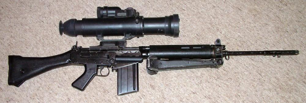

Back to the original question Longshoar........ Had a look at a couple today and it seems that (on ours.....) there are THREE flats on each of the rotating locking latches and you've got to align the most convenient flat on each latch consistent with its ability to rotate AND lock before you slide the mount onto the IWS cover rail. Have a look at yours
Hope this helps

E-Sarco IWS Bracket
I believe I can now answer my own question of today on the FNFal forum concerning the Sarco STANAG adaptor. It is the IWS bracket pictured in this thread. $ 175.00. Is that a good price?
Heres what I wposted on your other thread.
OWCH, if I was paying $175 USD for it I would be wanting the IWS mount that it fits to as well :-o
The only use for this Adapter is for it fit the IWS or PVS NVS Mounts. Personally I think the price is way over the top
If you hunt around on eBay you will stumble over one every now and then. It all depends on how much you NEED to have it.

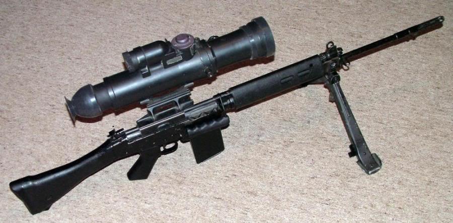

Along the same lines though, NZL1A1Collector, I believe you posted a picture of an SLR with the IWS fitted and some sort of bipod. Any idea what sort of bipod that was? It doesn't look like an Aussie L2A1 or British L4. Was it off an L7?

Well, now I have to find an L7 bipod... :lol:
It was an authorised modification in the UK Military, little known outside Northern Ireland. In fact it's so unusual that I haven't actually seen oine except in pictures. I've got a funny feeling that the picture might well be posed because a) it's daylight and b) the OG cover is on! (yes, I know that theres a light filter or a pinhole but it's more for zeroing in at 25 yards than observing!). If you are looking for a bipod Longshoar, it's worth bearing in mind that it's the same one as used on the US M-240. I think that Brian at BDL has or had some of the user handbooks for the sight mounted on the rifle set-up.
Great picture anyway. Thanks KtK
Peter,
Was any modification of the bipod required for fitting and, if so, could you describe it in enough detail to replicate?
Thanks
I have a funny feeling that you cut the top out of the 'bracket, bipod' and filed the inside parallel so that it would slide up, over the handguard caps. Then a hole was drilled through the bipod bracket to coincide with the hole in the handguard bracket and threaded on the right hand side. The threaded rivet on the right side of the handguard capo was drilled out, Lastly, a longer screw was put through the hole in the modified bipod bracket, left handguard, gas block right nadguard and screwed tight into the right side of the bipod bracket. But I could be wrong!
But clear pics by KtK will show all............ The next thing is to get a spare GPMG Bipod. Ouch......... that's going to be megga expensive!
Pete, When I modded these bipods myself. I simply used a long bolt that was the same thread as the handguard screw. This would go straight through the handguard threaded 'nut' & out through the other hole on the cut out bipod head. (Adaptor,bipod)
