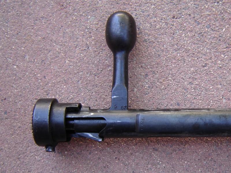

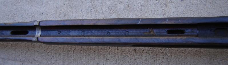

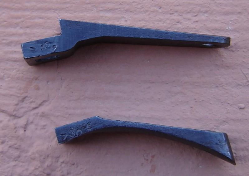

One other thing the numbers on the bolt of the T38 do not match the receiver and I cannot find any other assembly numbers on the exterior of this rifle. Where would other assembly numbers be or is this just a MM rifle?
Usually assembly numbers can be found at the barrel/action mating area, but on the bottom.

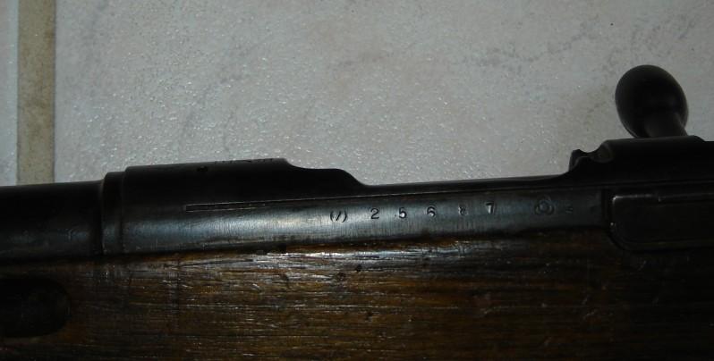

A rifle that late won't be matched by assembly number, it will be matched by the serial number on the receiver - you just have a mismatched rifle...
Your type 99 does appear to be a series 23 made made somewhere between July '43 to March 1944. Your serial number is an early 23 series and it should have had a monopod when made, although it does not show any signs of one. The monopod was dropped late in the 23 series. It also came with a dust cover.
