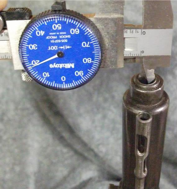

................................ The S mark also denoted that an S patronen reamer had been used in the chamber to ensure the 1905 round would work ok. On most rifles this would not have even cut metal, it was a safety precaution to ensure the neck diameter was sufficient.
The Germans shot M88 and M1905 ammo in these guns interchangeably when they had them in service, with the S round preferred for guns so converted because the rear sight leaf had been re-regulated accordingly. At short range, it didn't really change performance switching to M88 ammo, which the Germans were keen to use up as conversion of rifles to S pattern progressed.
Most GERMAN barelled 88's will have a bore diameter between .321 and .323, totally safe to fire the .323 military ammo OF THAT DAY.
Where it get dicey is that in 1934, the 8x57JS was beefed up considerably to a 198gn boat tailed spitzer with a heavier recoil impulse for use in the K98k and machine guns. I would NOT fire the M34 loading of 8x57JS in my Gew88, and neither did turkey who stuck with the M1905 version of the 8x57.
As stated before, SLUG YOUR BARREL before shooting standard 154gn 8x57 in your Gew88 rifle. Chances are you have the .323" bore, but you want to make sure - trust me.
