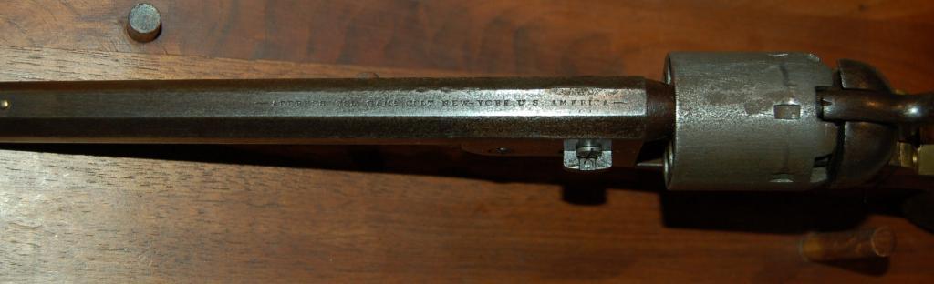

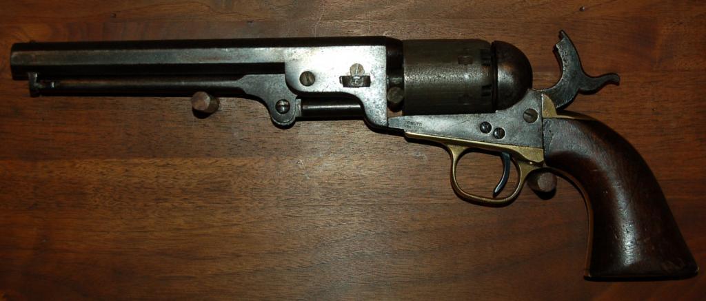

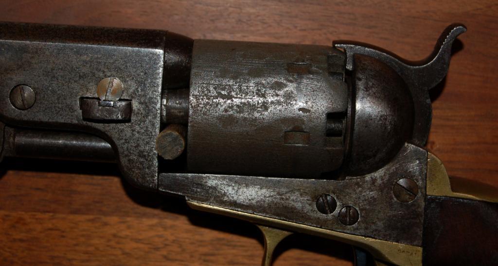

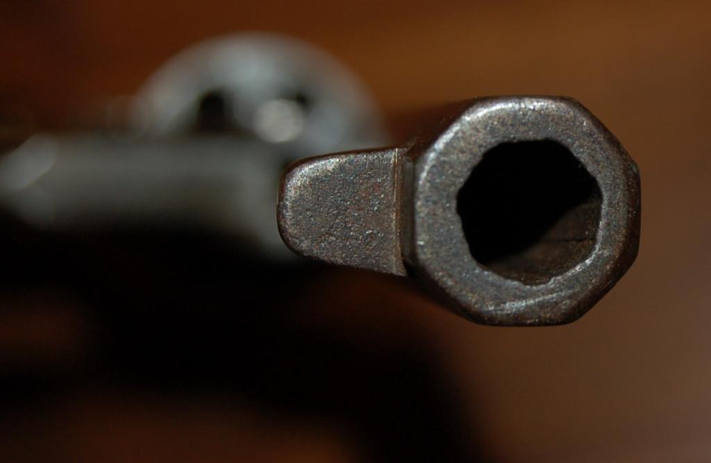

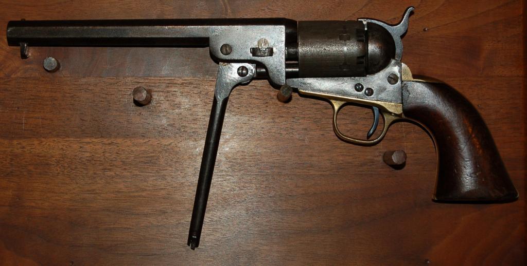

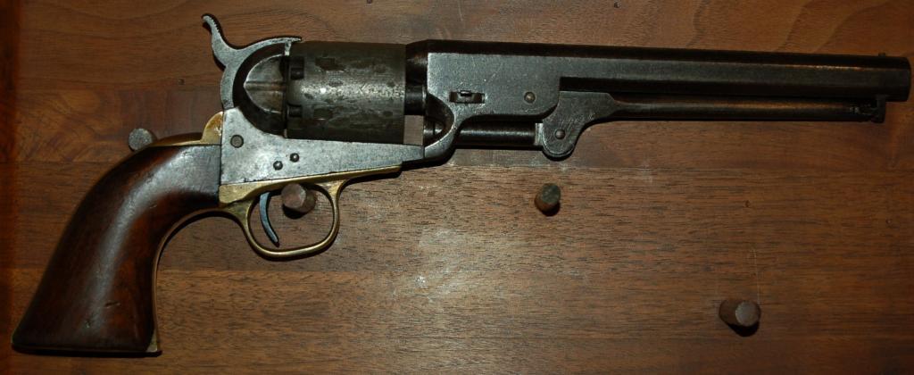

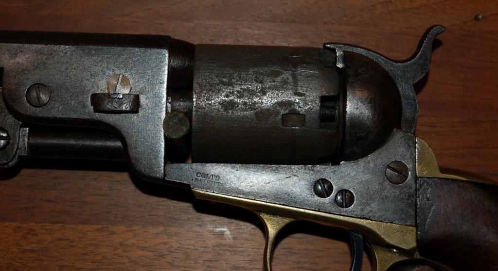

Sorry to be so cryptic with this but a close friend had this for many years and found it and ask me to get some information on it and whether it could be fired. From the best I can tell, it is fully functional but I know almost nothing about revolvers. I took it apart as far as removing the barrel and cylinder. The barrel has some pitting in it but the rifling is strong. The cylinder chambers have some minor pitting in them but the cylinder has the unhealthy looking grey cast to it. There is minor pitting on some of the surface parts as you can see in the photos. The brass looks great, the grips look pretty good. The end of the muzzle and the front sight are a little worn down (rounded). The gun was produced in 1863 but does not appear to be a military contract piece. I told him the standard "I don't recommend firing originals" but he'd like to be thorough.
I'm not overly concerned with the barrel, maybe the cylinder, not from pitting but from the color. It looks to have had rust ground off of it or something thus the gouges. Some of the engraving remains but the serial number is extremely faint. It is enough there that I believe it matches the rest of the gun. The gun is not all matching, the loading leaver is a replacement. Other than that, numbers match as far as I've taken it apart. The screw holding the wedge looks newer/new but would have been replaced many years ago. My other concern is the wedge. It does not seem to be especially tight and if it is not tapped in place hard there is some slight movement of the front frame. Tapped in solid, it seems ok. There is some slight travel in the cylinder but I have no way to measure. The gun has very little if any original finish on it that I can tell but does have a patina which is marked from a previous cleaning. I have no idea when this was done and neither does my friend.

That looks like something I would investigate very closely, to see if I could make a shooter out of it, while hoping that the collectors would pass by on the other side. If the ratchet is usable, then screws and springs are all "doable". The wedge, however, is the absolute key piece for these revolvers. To a certain extent, one can even fine tune the position of the barrel section, and thus the cylinder end play, by manipulating the wedge. But if it does not fit snugly, which means needing a very firm pressure or a tap with a plastic hammer to seat it right home, then the open-top mechanism is a very wobbly affair. The screw is there to stop it coming loose and getting lost, not to tighten up a slack wedge!
It is not easy to tell from photos, but the greyish look to the cylinder could be the result of leaving it in rust-remover for too long. Commercial rust-remover, as sold for D-I-Y car repairers, is more or less weak phosphoric acid. I wanted to clean an old screw-cutting die once, that had a lot of surface rust from bad storage, although the cutting edges seemed OK. I put it in a plastic cup with a good shot of rust-remover, watered down to cover the die completely, and promptly forgot about it for a couple of weeks.
When I finally took it out and cleaned it, it had developed that grey look, having been in effect weakly parkerized. That may have been what happened here, in which case collectors will run a mile, but the thing will still work!
