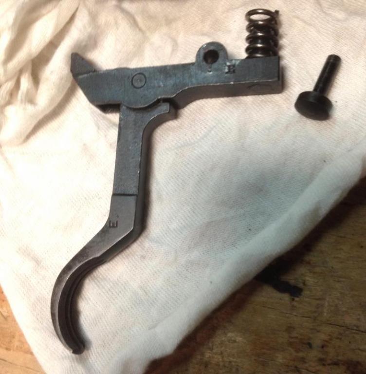

Here's a few more photos while we wait. First off is my "E" marked trigger and sear:

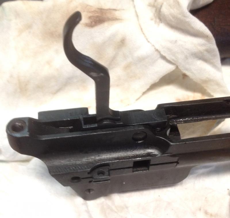

I installed that back into the action yesterday:

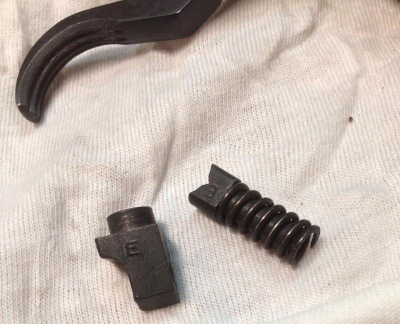

Next up, I think I'll put the safety back together today or tomorrow time permitting. Here are my safety lock plunger and stop, both "E" marked of course:

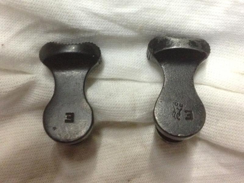

I have a bit of a dilemma with the actual safety lever. I have somehow ended up with two of them, both Eddystone marked. One is in nice shape, but just has the "E" stamp. The other has bit of the finish worn off around the edges however, it has both the "E" stamp and also the eagle head stamp. At the moment I am leaning towards using the safety with the eagle head stamp even though it's in worse shape. I just really like those eagle head stamps :D I'll post a photo of both of them later.

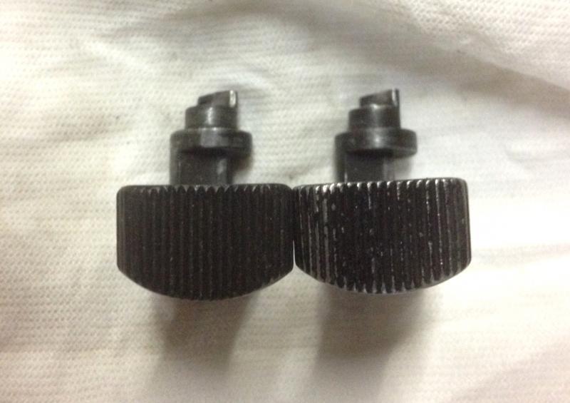

Here's a couple of photos of the safety levers I mentioned yesterday. As you can see, the eagle head stamped one on the right is much more worn than the one on the left. Maybe to the point where it's not the best match for my rifle. But as I said, I really do like the eagle head stamps so that's the one I'm leaning towards using.
Here's some photos.
-Derek
https://www.milsurps.com/images/impo...ecd46e48-1.jpg
https://www.milsurps.com/images/impo...cccf5b3f-1.jpg
I'd go with the eagle head too, more interesting. On a small part like that some cold blue will touch it up nice, just a thought.

Oh, I did decide to use the eagle head safety catch btw. Some cool blue touch up might be just the ticket!
