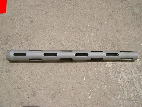

Hi Patrick, Said cone is currently a tube, I need to make a mandrel and force the tube over to make the cone. The end result should look like this...I hope.
https://www.milsurps.com/images/impo...12_zps6b-1.jpg
