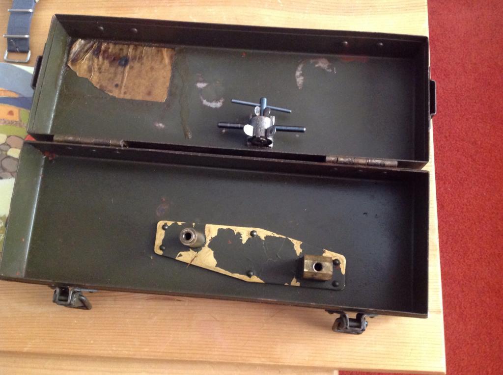

I have a tin that has 2 threaded attachment points with the scope screwing to both, is this a mod of some description. It has Case,STG.TEL
No8 Mark 1
BE Ltd OS906A
1941 stamped on it

Certainly stamped correctly and looks right with the original adjustment tool in the lid too, no worries IMHO.
4 Attachment(s)
Originally they were ALL threaded in both pillars. But due to slight discrepancies and some brackets not fitting there was a misc instruction (EMER Inst and SL's V-something or other as I recall) that only the rear pillar should be threaded. This was because if you left only the front pillar threaded, it would bring the scope rearwards a tad - where the eye cap would foul the end of the case.
