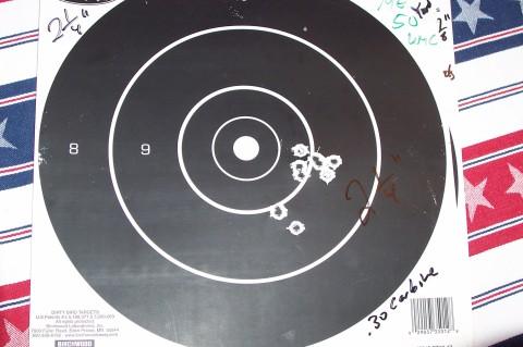

https://www.milsurps.com/images/impo...3433DXRO-1.jpg
this group I think is one of the best I ever got with the carbine. It was at 100

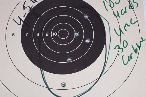

50 yards

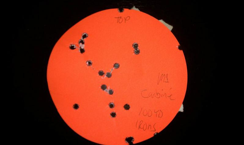

https://www.milsurps.com/images/impo...3433DXRO-2.jpg
ABPOS, When you fire from a rest, are you supporting the front of the stock in your hand still? When I shot from a rest without resting the weapon in my cupped off-hand on top of the rest, i get groups like that. When I rest it in my off-hand on top of the rest, I get better groups. I did a post about it here several years ago
Interesting. I'll have to try that. I wonder why still using your hand to grasp it would make a difference. Yeah, I'm pretty sure I either used bags or that caldwell green thingy with the U shape in it. And then my left hand on the rear stock.
To be honest, I thought 4-5/8 was pretty good at 100 yards. For a carbine. But maybe I could tighten that up. The first group I posted was the very first group I shot and I think I found a 4-3/16" group at 100 when looking through them. That third pic is 10 rounds.
