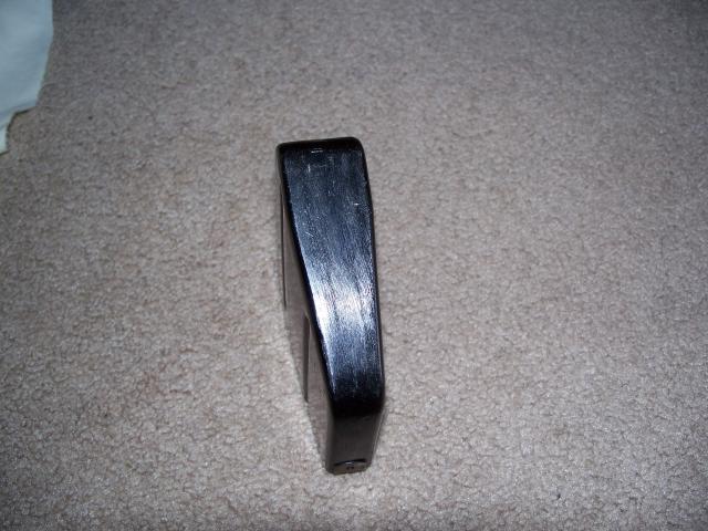

It does appear to me to be a no4 mag, I think just a really crappy knockoff. Also notice the sanding marks all over it... ?
https://www.milsurps.com/images/impo...100_1808-1.jpg
https://www.milsurps.com/images/impo...100_1813-1.jpg
It's this one below that I am hoping shows the problem I think I have. The top left side of the mag is so much higher than the right. The left seats up against the receiver bottom flush, the right side doesn't come close, and the whole thing hangs too low and as mentioned previously won't latch...
At any rate, the bolt barely strips a cartridge off, sometimes going over top of the rounds. When it does strip one it rams it nose first into the bottom of guide rail and goes nowhere.
https://www.milsurps.com/images/impo...100_1820-1.jpg
https://www.milsurps.com/images/impo...100_1810-1.jpg
The left side is MEANT to be higher than the other. It is a reminder of its ancestry when the first No4 prototypes had a magazine cut-off. It allows the cut-off to slide over. Never modified when the cut-off was deleted from No4 series production.

That crappy sanding appears on brand new UK production ones. Paul, just get on and fit the bloody thing as we've suggested. It should take 5 minutes to get that upo and running if you want my opinion as a bit part amateur

Well, Peter was an Armourer officer for a "Number of years" and if he had it there'd be no more problems...the only thing to do without actually having my hands on it would be touch the spine with a file until it sits correctly. Sounds like there's other things though. Can you just wait for a local gun show? There's bound to be some for $25 or so. That's what they go for...maybe $35 but not more. They'll be used...
Why do you have to bother with new? Just do what we'd do.......... Get another out of the tray - any one will do - and fit that to the rifle. Test for feed and functioning with drill rounds. Get it sorted, then bar out the old number(s) and send the rifle out, back to the Armoury
At the big workshops we'd wait until there were 25 or 30 or so defective magazines with worn back straps or dents and start a big repair programme. Cut back the worn part of the back strap, silver solder new, take out dents on a mandrill, police out lightly punched numbers then send through the phosphating plant. They''d all come out not exactly new, but rebuilt for a further 30 years of life. I'll tell you this........ We didn't bin very much!
I'm thinking that magazine can be made to work and you will likely have to do something to any other mag as well, unless you rob a known functioning unit from another rifle and it just happens to fit.
The feed lips will bend quite readily. you may even be able to drive this one in with educated blows of a soft faced rubber mallet. The mallet taps will at least show you where the high spots are that can be massaged down. Fitting your first magazine might take an hour or three, but it can usually be done without removing metal. Just controlled reforming. After fitting, don't remove and replace the magazine except for general maintenance. It's not for quick mag swaps! Reloading is done via chargers from the top side of the rifle. That or single rounds also inserted whilst the magazine is installed.
I am making this one work, but it's taking serious massaging. I will keep an eye out for an original for a decent price and pick it up though.
I had to file down the backstrap quite a bit to get it to latch. Probably .125 of an inch. It now latches tight as hell, but the feed problems are still present. Playing with the feed lips it will now strip a cartridge off, but it's ramming them into the top of the breech instead of the feed ramp as it did before. Somewhere will be a happy medium I hope. Looking pretty mangled so far.
