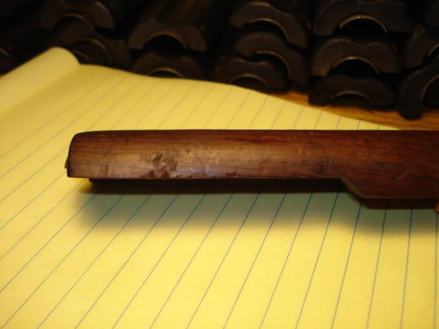

Is your HG a 2 rivet type II?
Do you remember this mystery HG I pulled from a bulk box?
Surely not made to spec's :move eek:

https://www.milsurps.com/images/impo...DSC08666-1.jpg
https://www.milsurps.com/images/impo...DSC08667-1.jpg
https://www.milsurps.com/images/impo...DSC08663-1.jpg
https://www.milsurps.com/images/impo...DSC08670-1.jpg
Jeez; that hand guard is a monster! Kill it before it multiplies!
