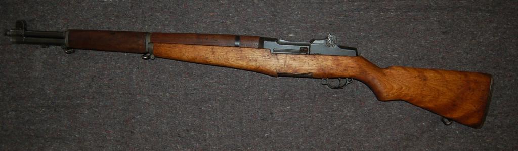

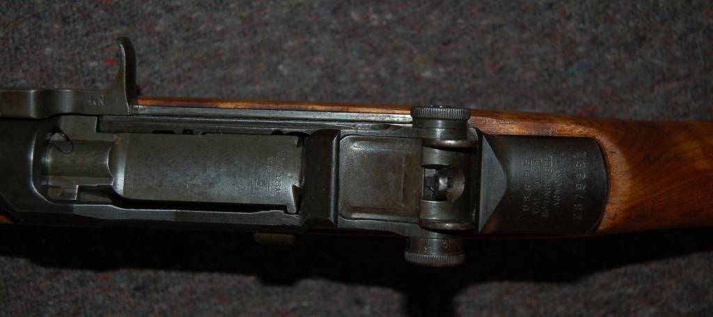

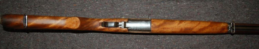

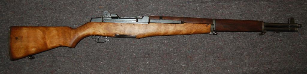

Started cleaning the stock. Main stock is much lighter than the fore end and rear hand guard. Fore end is nearly black and doesn't seem to want to get any lighter. Main stock is definitely showing indications of tiger striping but not the normal kind. Not sure what it's going to look like when it's done. The grain is all over the place and has a lot of swirls. Will try steaming it this evening and possibly do some light sanding in two spots that are scratched badly. These two areas don't match the condition of the rest of the wood or I'd let them alone.
Yep, birch stock. Nice job on the clean up. Looks a whole lot better.
Looks great. I hope it shoots at least as good as it looks.
Sadly, I think I'll start looking for a walnut stock. I really like this one and I didn't do that much to it. I could sand all the dings out of it and it would really look sharp. But, as they weren't made until the late 50's, not really appropriate for WWII displays. I'm not going to get rid of this one though. It can be my range stock or the other one just for my presentations. I may try to locate birch handguards. Always something.
Don't sand it too much though. They can come up smooth and they'll never take a stain again. The stuff is like glass after for turning stain.
