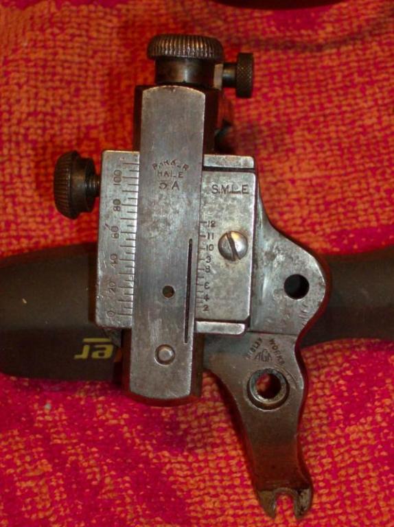

1 Attachment(s)
Thanks again everyone. So now I'm wondering exactly what part and screw I need. The sight here isn't exactly like the one pictured by muffet.2008. Here's a better pic of the one I have:

Hi Lou,
Thanks for posting a picture of your sight. It's a 2nd generation 5A. Go to http://www.helstongunsmiths.com and click on "target sights" to view the sight you need info on. They have a 5A modified sight that shows the parts you need. Yours required the small windage indicator plate and screw.

Ooops - sorry louthepou, rgg7 is totally correct, you need pointer plate and screw - I failed to look at the pic properly and assumed erroneously it was PH5A like mine with a scale plate held on by 2 x screws - my apologies
