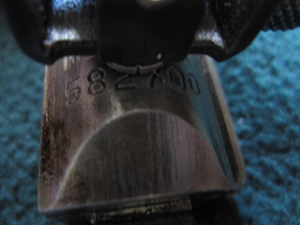

If it has a 6 digit serial number, it has been refitted with many later parts. If it's 7 digit, then the barrel date looks too early to me. - Bob
It must be 6 digits because when I looked up the serial number manufacture date range, it matched the date stamped on the barrel. I think it has been fitted with later parts during a rebuild.

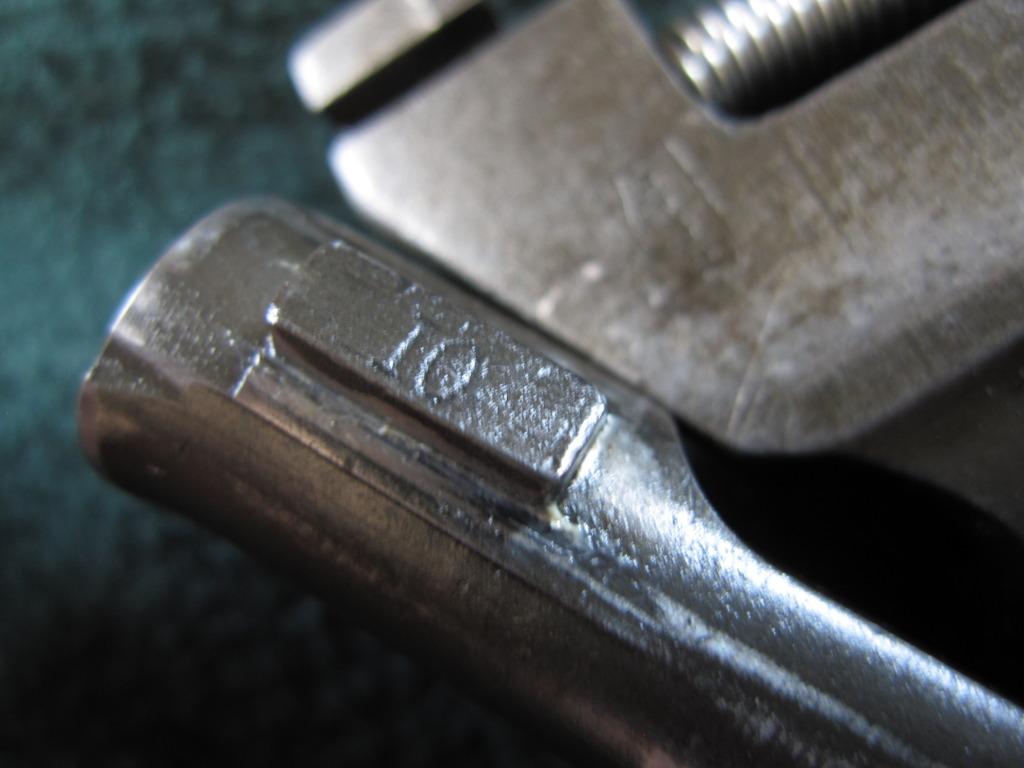

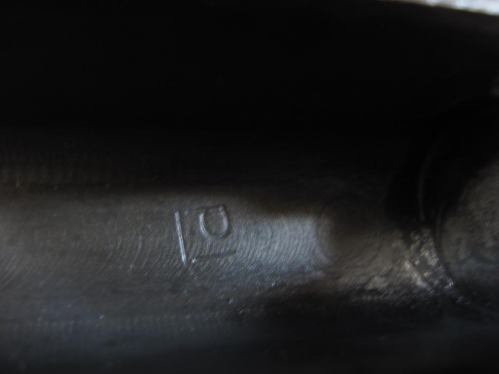

What's the "PI" mark on the inside of the op rod? My Underwood also has this mark in the same place.

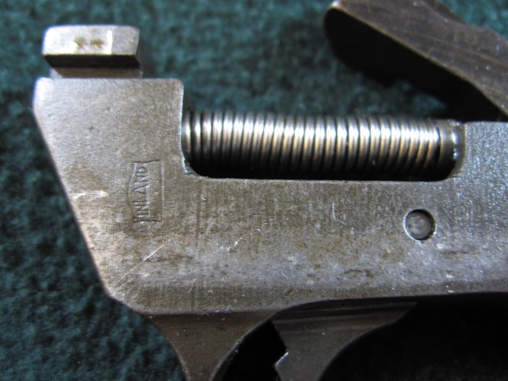

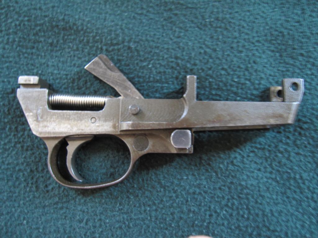

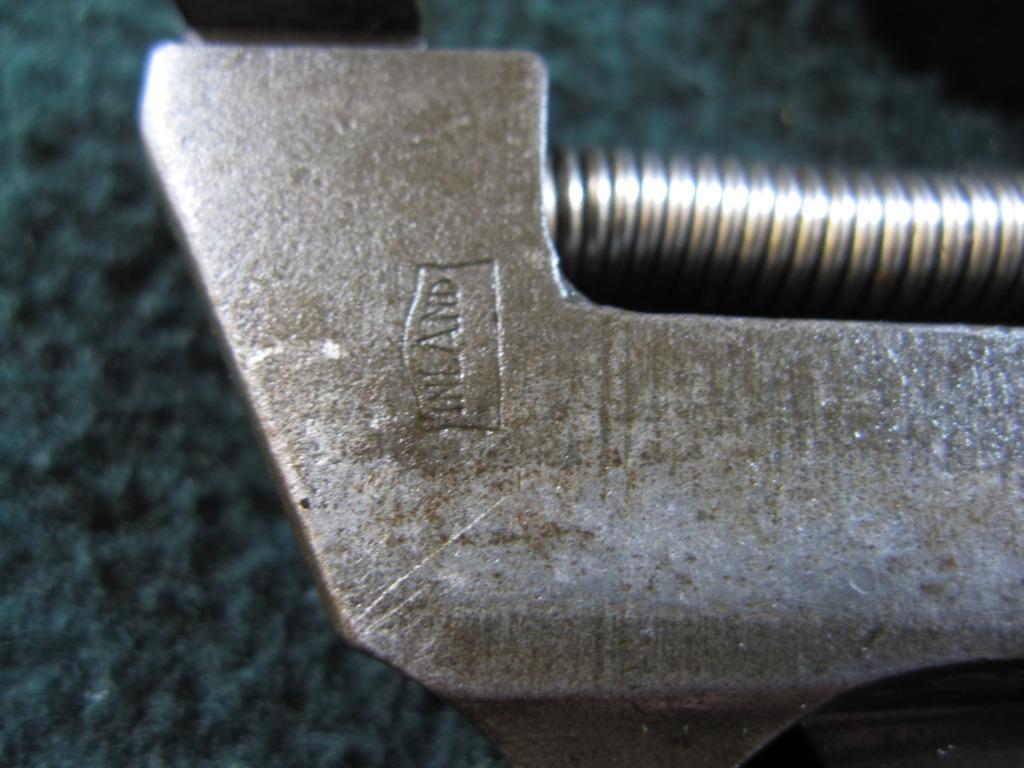

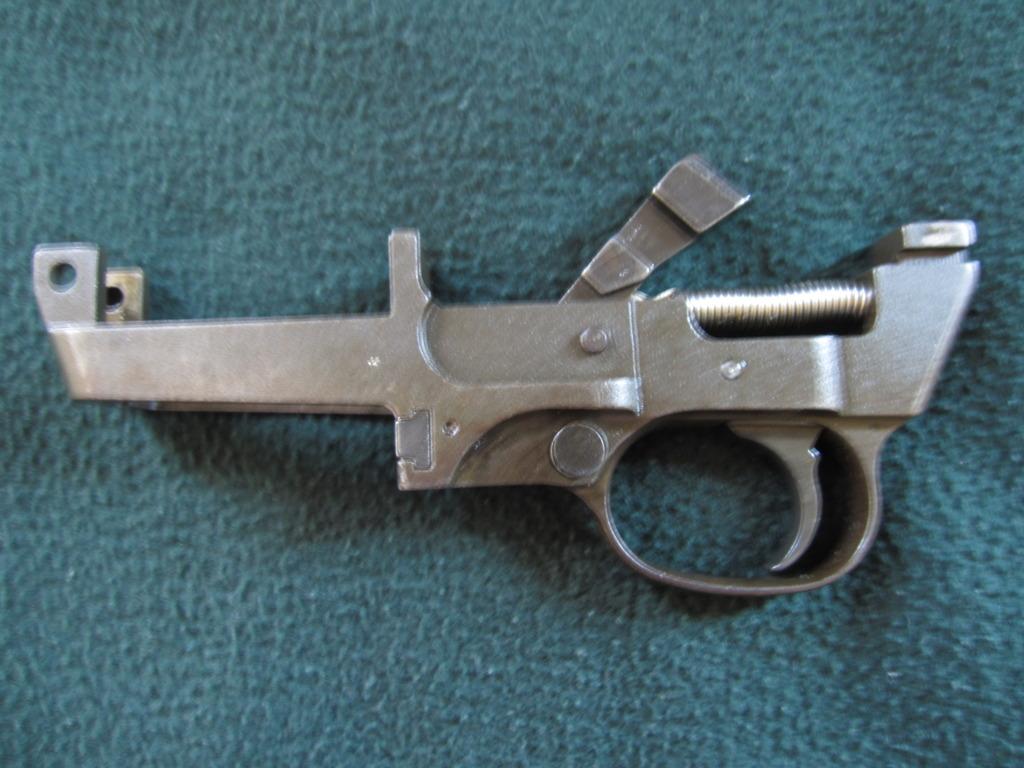

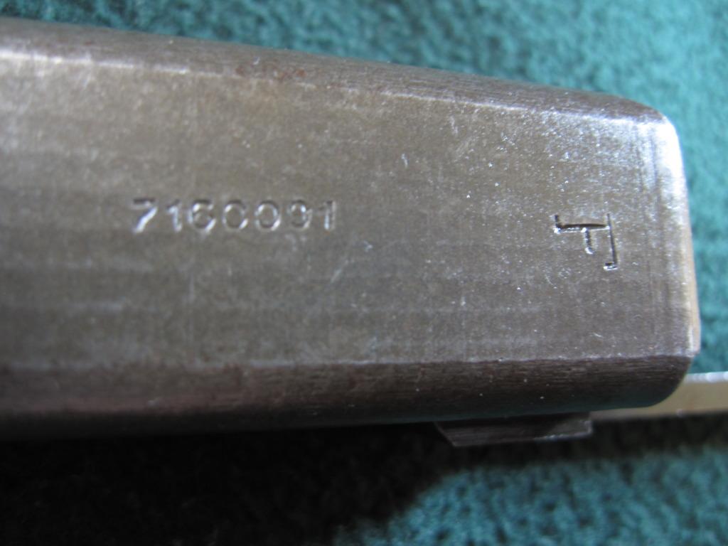

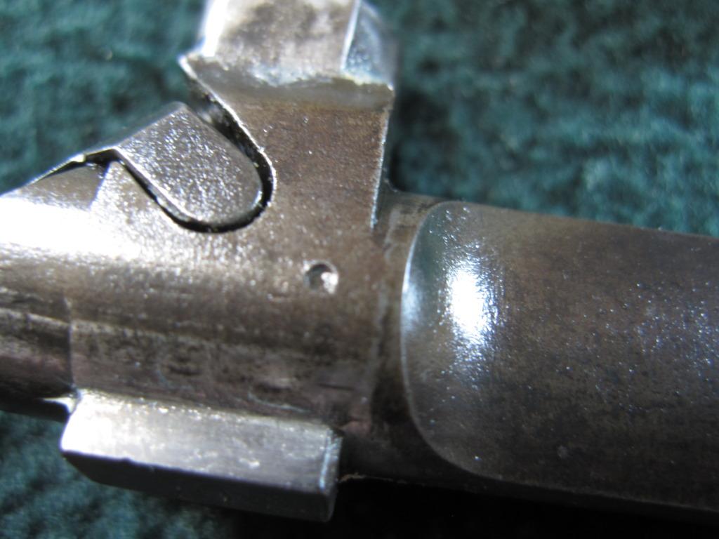

Made by Packard for Inland. That's a later operating slide. I also see the later Type 5 Inland trigger housing with the vertical logo and the hole on the left side. - Bob
Packard, as in the car manufacturer?
The trigger housing has been through at least one rebuild as it has the oil hole drilled in it.
