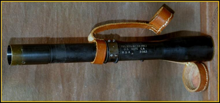

4 different types of scopes with the same sized caps:
no32 sniper rifle with adjustable post and bar reticle
no42 tank? fixed glass? reticle
https://www.milsurps.com/images/impo...o42scope-1.jpg
no53 tank? fixed glass? reticle
https://www.milsurps.com/images/impo...1_563JPG-1.jpg
just to confuse you there is also a no71 which is a no32 converted for use in a tank. fitted with a glass reticle

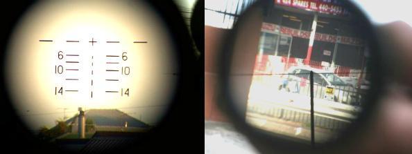

no53 reticle left no32 right. picture from Lee Enfield .303 - | 150 best links to everything Lee Enfield.
https://www.milsurps.com/images/impo...hreticle-1.jpg

Interesting how they were able to fit an etched glass reticule to the No71, but not to the No32. There was a trial done in 1944/45 which recommended a modified reticule including a two-thickness crossbar or horizontal wire. The reason obviously was that in low light you can then find the heavier horizontal bar as easily as the vertical post and use the two to align on the target without actually seeing the tip of the post or the crosswire/horizontal bar, as you can with the German or No.8 reticule. Some of the WWI German scopes went one better and had a short vertical bar projecting down from the top of the field of view; to be used against the lighter skyline of course.
