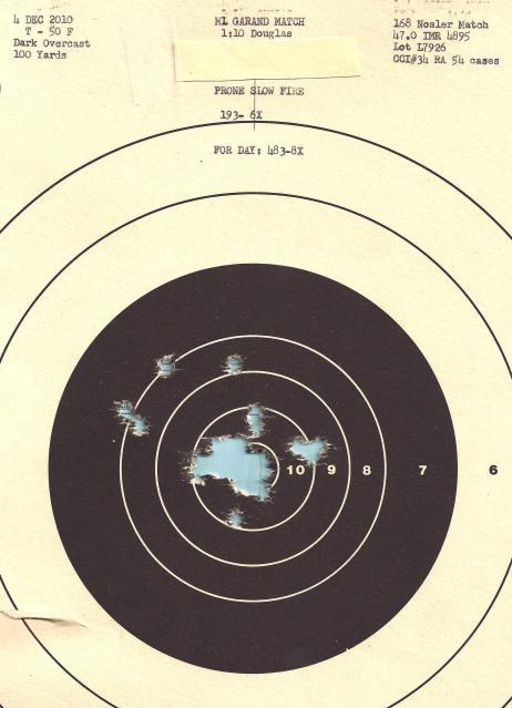

My load of 168 Match, 47.0 grains IMR 4895, RA 54 cases, CCI #34 on various 100 yard reduced targets, all fired in competition.
This one in Dec 2010. For the day, I shot a 483, which is very good with a Garand. This prone target is not my highest score, but the nice group in the middle shows the accuracy potential of this load.
https://www.milsurps.com/images/impo...4Dec2010-1.jpg

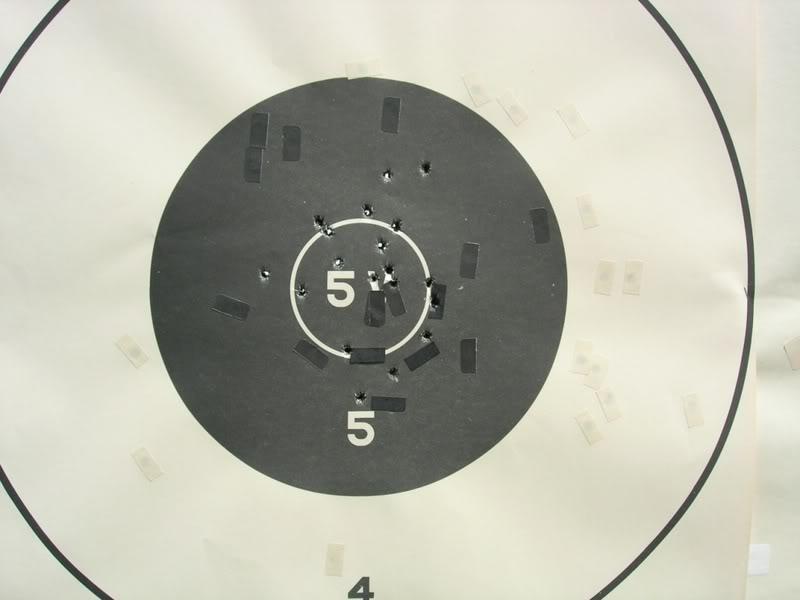

20 rounds prone SF, 200 yards on the 5V target. My Club found a supply and shot vintage matches on the thing. What a hoot! That target was the target used at the National Matches during the 50's and 60's. Shoot a "4" and you may still win. Shoot two "4"'s and you might place in the upper ten, shoot three "4's" and you will be way down the list.
Matches were often determined by V count.
https://www.milsurps.com/images/impo...Nosler47-1.jpg
