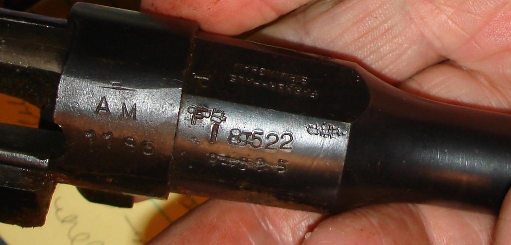

F303 I have a better pic of it I'll post . The F I can been more clearly. Def not in Skennerton's. Thank you, I really appreciate your input
I just picked up a BSA 1918 MkIII* that is a true time capsule. I'll start a new thread in the next day or two with pics.
F303 Would that S/N you found been amongst barreled actions sent over?
Here's the pic I promised of the F I
https://www.milsurps.com/images/impo...2aawqmbp-1.jpg
FWIW Other side
https://www.milsurps.com/images/impo...y6d2rucd-1.jpg
I never have mentioned that though this has a tubed barrel done by Parker-Hale the muzzle is devoid of any lettering. Much thanks to all that have posted especially Frederick303.

A number of the trifles show they were originally Irish rifles sent over to BSA be re-tubed to .22 cal by Parker Hale in the 1951 time frame (BB date).
most of these 1951 rifles have a small FF mark in a circle on the underside of the forend, just in front of the triggerguard. Not sure if your rifle has that or not. The mark in on the wood, not the metal on these post was re-tube

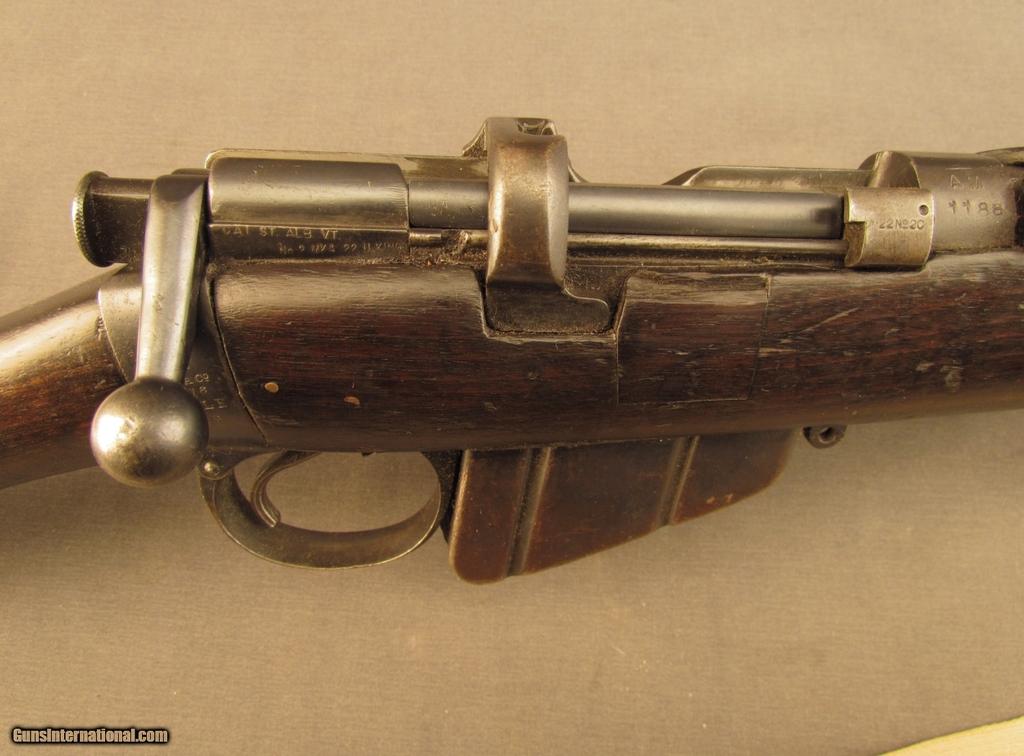

It turns out my rifle is very much like this one found in this thread @ Another Enfield #2 MK IV Trainer ... CAI Import - AR15.Com Archive
with a sleeved Parker-Hale barrel on a 1916 BSA receiver. Mine also is marked just to the rear of the charger bridge below the CAI import mark: No 2 MK4 22 U KING. But it differs in that it has the 22No2C bolt head and an AM s/n.
