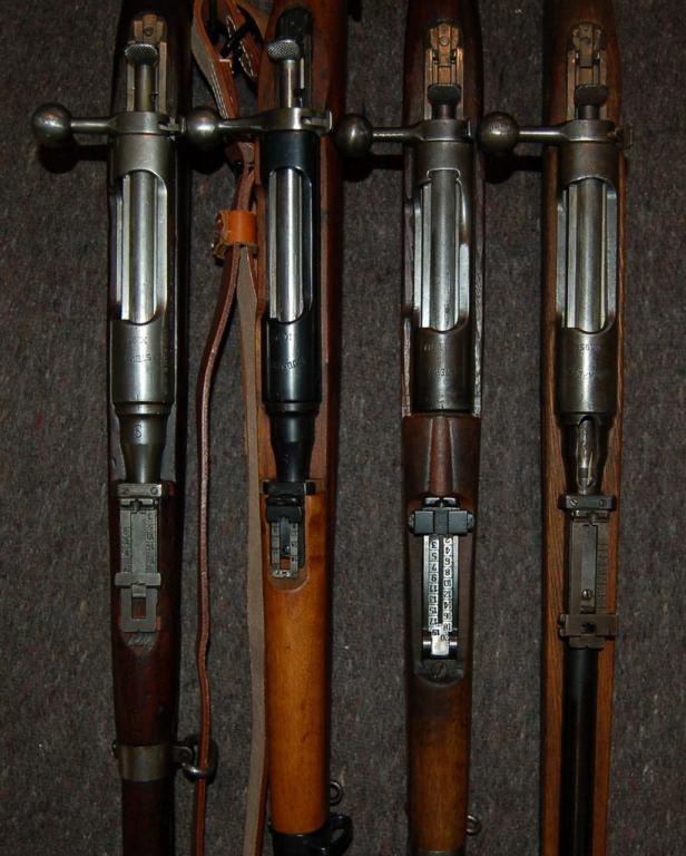

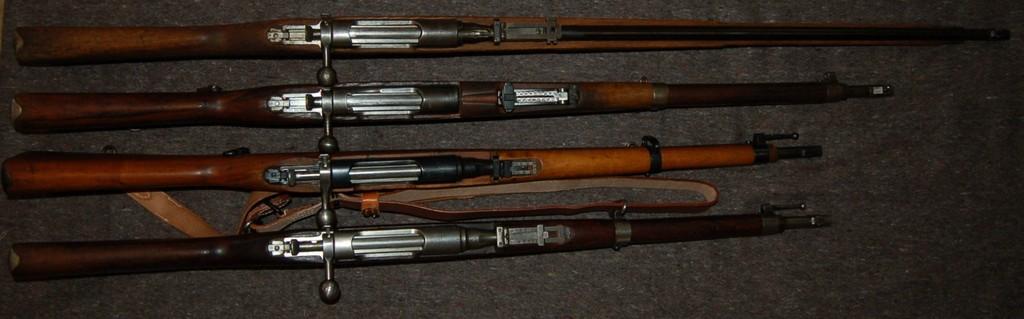

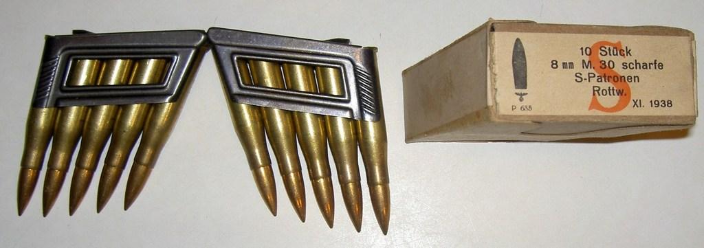

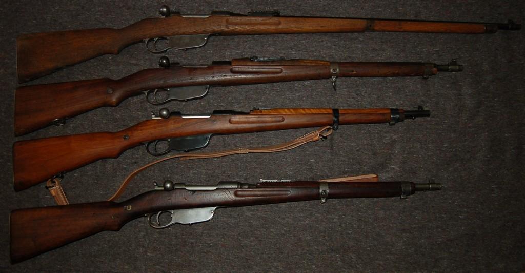

Figured I'd post a comparison of the various M95 types. The top rifle is an M95 which was deactivated. It is not complete at the moment as I have scavenged a few parts off of it for the M95M project. I am getting the parts for it also so it won't be bare forever. The second from the top is the M95M which is the subject of this discussion. The third from the top is an original M95 carbine. The bottom is an M95 rifle which was converted between the wars to a carbine.
Note the lengths of the stocks. M95M's were apparently made from full length rifles. I had been thinking they were made from the carbines but two factors suggest otherwise. Obviously, the stocks are too short for the conversion and as the Carbines were considered improvements over the rifles, why use a carbine for a second conversion when plenty of rifles were around. The barrel bands don't line up on any of them except the original carbine and the M95M. All three of the original caliber rifles have barrel bands that use screws to hold them in place, the M95M's used either these same bands or the band which I included a photo of earlier if it was of the cavalry type.
The third photo shows how part of the rifle was demilled. An oval hole was drilled out of the barrel. Bolt face was also welded and firing pin clipped.
https://www.milsurps.com/images/impo...mxknnvcs-1.jpg
https://www.milsurps.com/images/impo...o1zr6njb-1.jpg
https://www.milsurps.com/images/impo...optlzfgx-1.jpg

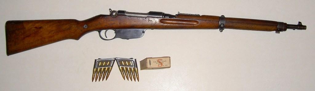

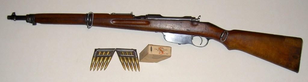

My son-in-law picked up this M95 at a local gun show this past weekend. Is it one that was to a carbine?
https://www.milsurps.com/images/impo...20M95201-1.jpg
https://www.milsurps.com/images/impo...20M95202-1.jpg
He also found this ammo.
https://www.milsurps.com/images/impo...patronen-1.jpg
Originally that carbine was a M95 Infantry Rifle (you can tell by the long rear sight). In the 1930s it was cut down to carbine length and rechambered to 8x56r. If it has a 'S' on the chamber then it was converted in Austria, if it has a 'H' it was converted in Hungary. Proper designation would be M95/30.
