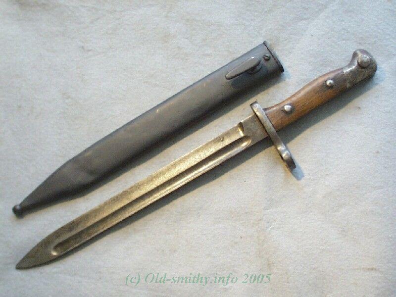

I agree with Bill. This is a M1910. These were made in Czechoslovakia. The M1936 had a longer blade. M1936 workmanship was not as good as the M1910.
This is a picture I had on my computer. Didn't have any close ups. I'll have to dig it out to see what it has for markings. I know it has a serial number on the pommel.
The serial number placement is the same as the Mexican M1936 bayonet so I suspect that it is a M1910 refurbished by the Mexicans at their arsenal. This is the first short bladed one that I've seen. By the way the circle A and the circle Z of this type has nothing to do with Czechoslovakian manufacture. They are inspection marks used at the arsenal in Mexico. My M1936 Mauser has them in several places and it was completely made in Mexico.
Dan in Texas
The bayonet does not look shortened at least not 10" worth, that would have meant the original fuller was very very short on the blade, not something I have ever seen, although almost to the top isn't uncommon. Looking on my site this is the 1910 and mine has the circle z mark as well

Carl, is it your understanding that these bayonets were originally made in Czechoslovakia or Mexico? Obviously, if originally made in Czechoslovakia it may have subsequently been refurbished in Mexico which may have resulted in additional markings being applied.
I thought they were made in Czechoslovakia
