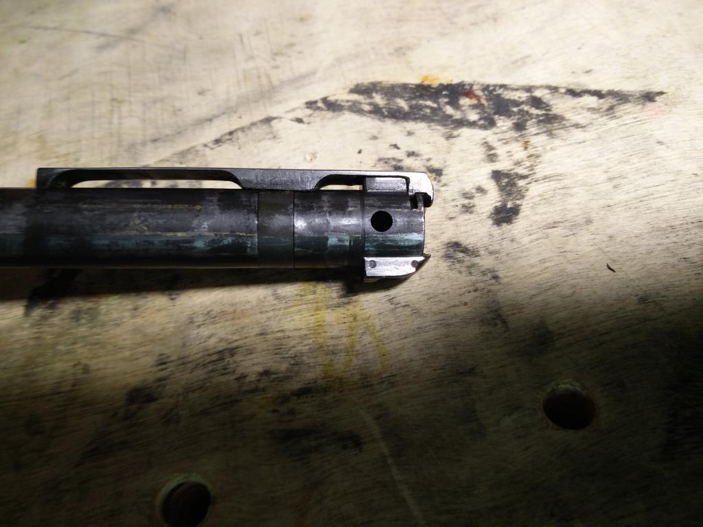

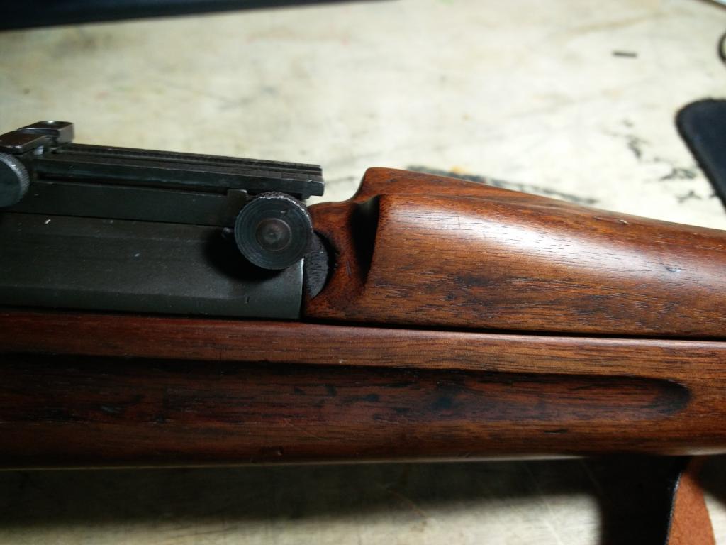

The sanding doesn't help but I've seen far worse. Staining the wood the original purplish brown color followed by a couple of coats of raw linseed oil rubbed-in would improve the rifle's appearance considerably. The handguard is from ca.1905, or a much earlier rifle, that has been notched for the later sight which is a pity, because original handguards from that period are scarce. Correct handguards with the circular windage knob cut are easy to find and inexpensive. How is the bolt marked and what are the measurements of the gas relief ports on the bottom? The original butt plate was smooth but the fine-checkered one on it is much harder to find so I'd leave it as is. All things considered, it's a very nice rifle and certainly worth a little effort.
