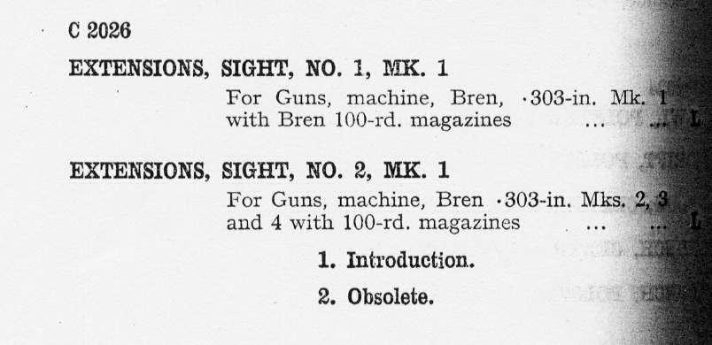

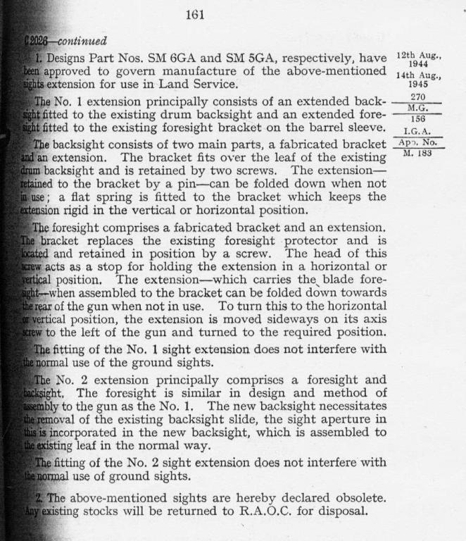

DDEIP3815 13/11/1944 Bren .303" -in Mk 1 Instructions to Guide Fitting of Extensions Sight No 1 Mk 1
DDEIP3811 13/11/1944 Bren .303" -in Mks 2, 3 & 4 Instructions to Guide Fitting of Extensions Sight No 2 Mk 1
DD(E)3432 04/01/1943 Sight Extension Bren .303" -in for use with 100 Round Magazine
DD(E)3433 04/01/1943 Sight Extension Bren .303" -in Mk 2 for use with 100 Round Magazine

Interesting. No wonder that we'd never seen them. Introduced and declared obsolete on the same day. You have to do it that long winded way to bring the item onto the VAOS list and codify it before you can declare it obsolete otherrwise you end up with a backlog of obsolete kit which the blanket stackers can't get rid of.
It does seem very late on to introduce such a sight, given that the drums were pretty much obsolescent by then
