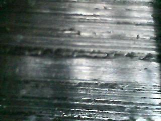

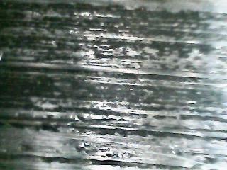

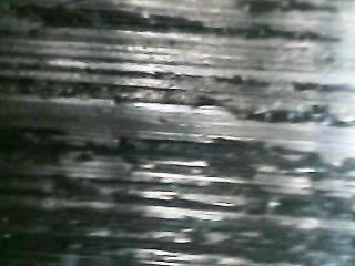

Then I cleaned it and borescoped it. After paying $350.00 to have it rebored/rerifled this was a bad surprise !
https://www.milsurps.com/images/impo.../J3LoTwt-1.jpg
https://www.milsurps.com/images/impo.../EBY07S9-1.jpg
https://www.milsurps.com/images/impo.../CsED8fD-1.jpg

Just a heads up should any of you contemplate having a barrel rebored/rerifled.
I spent $350 with OregonGunsmithing to have my 280 Ross rifle rebored to .308 (the 280 case necked up)
The photos below show what I got back.
When I raised my concerns I was told:
Old steel rifle barrels are pourus.
Our site has a disclaimer denying any liability.
Having had 10 plus rifles rebored by others w/o such issues, I'd urge caution.

In retrospect, .287 to .308 was probably was not a good idea. BUT like a fool I thought an ethical firm would have done the "drill out" and scoped the hole. When severe pitting was still evident an ethical firm would have called the customer and said this is a NOGO and suggested going to 33 or 35.
Instead these people just cut new rifling over the old pitting, did a 1/2 azz lapping job, charged me another 50 bucks to send it back and then, when confronted, gave me BS about old steel porosity.
I am a member of MANY forums across the net. The word is out.:red face:
Was the bore slugged and mic'd before reaming out. If so, what was the ID of the bore on the lands and on the grooves?
I have no idea what they DID but I know what they DID NOT do.
1. After drilling they never scoped the hole.
2. They rifled it over the old pitting.
3. They lapped it with (looking at the scratches) 60 grit emery paper.
4. They never inspected the finished job.
5. They blamed their shoddy work on porus steel.
6. They refuse to either fix it or refund my money.
If you look at their shop on Facebook, it is not comforting.:red face:
