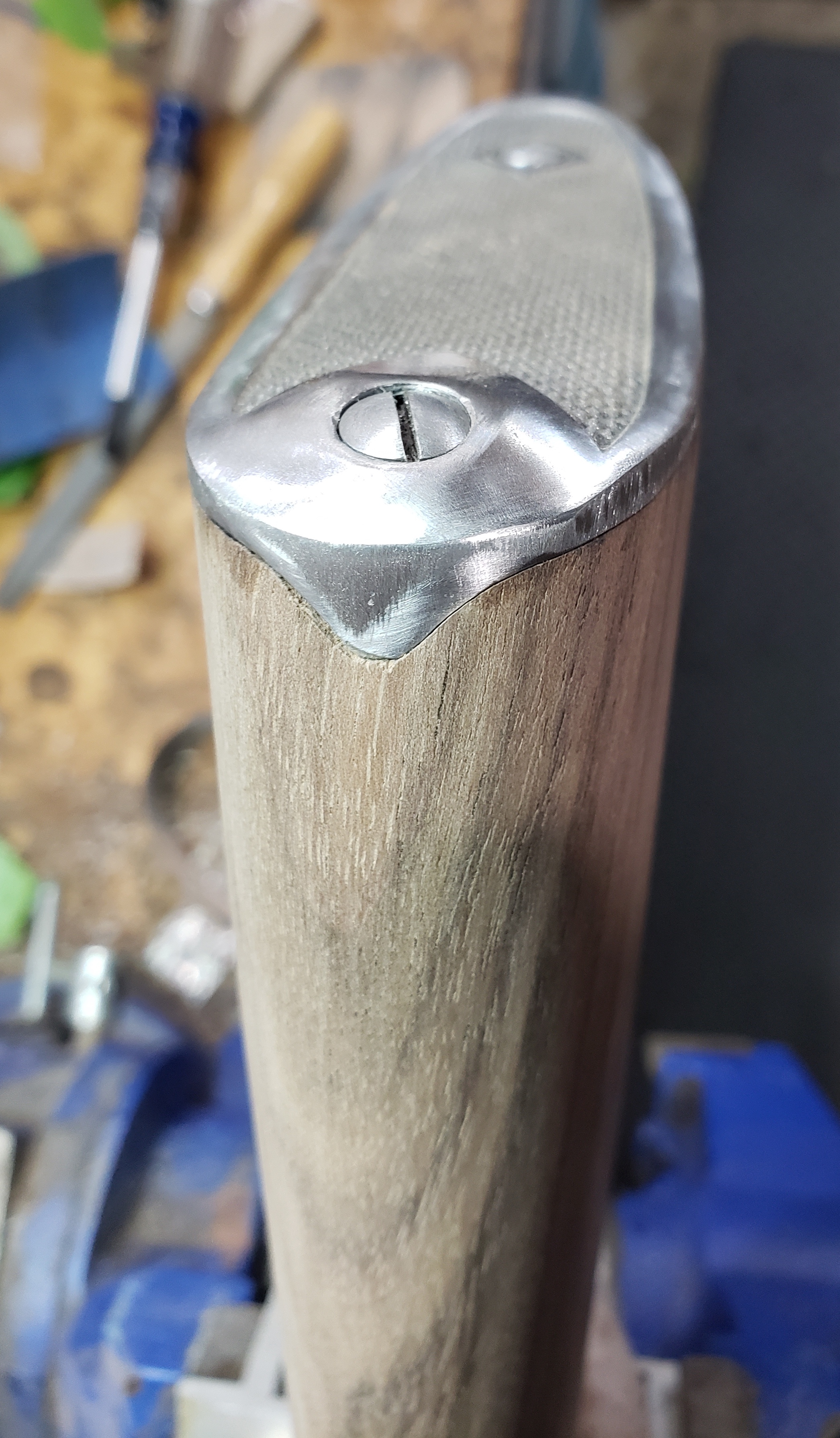

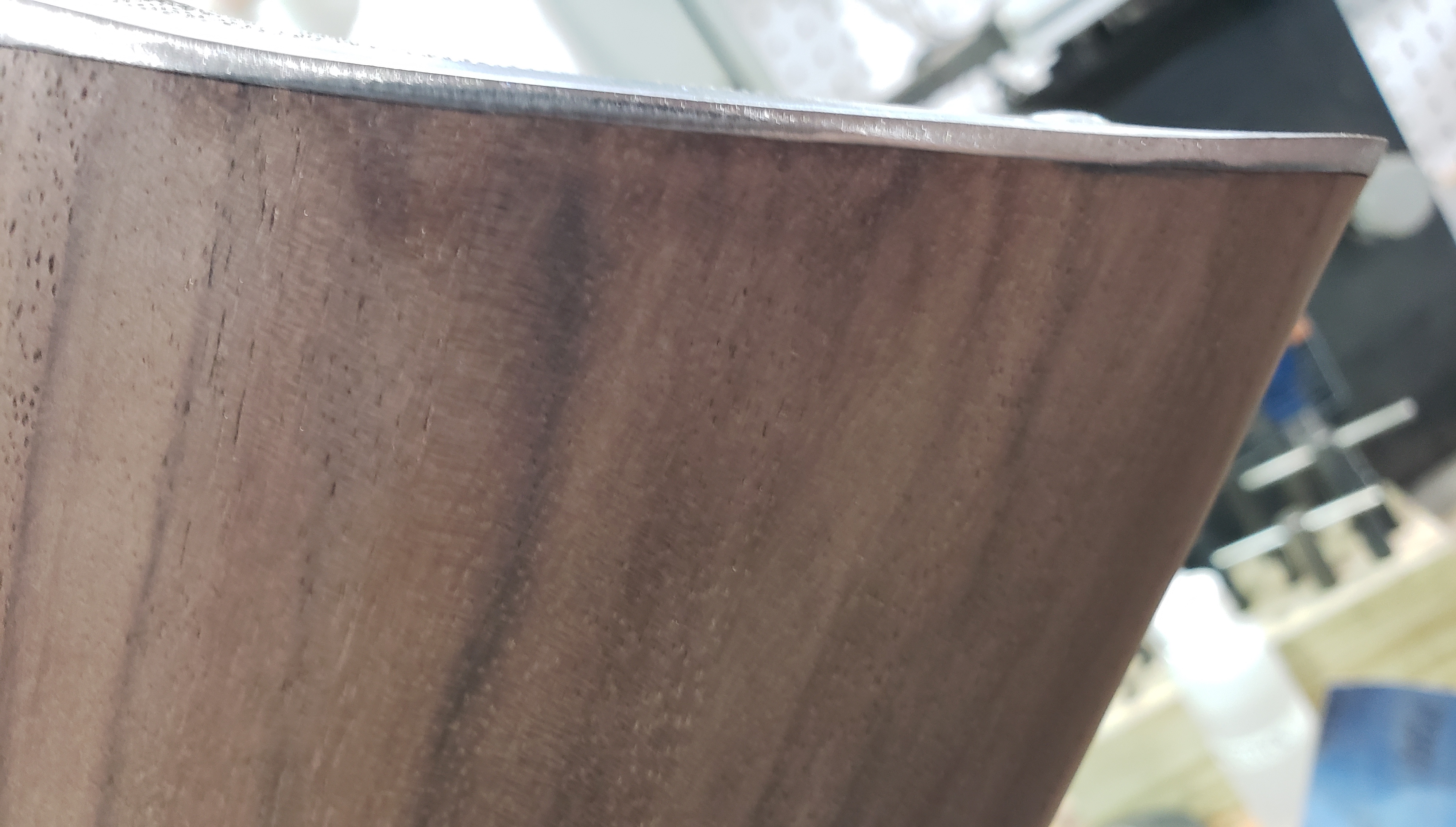

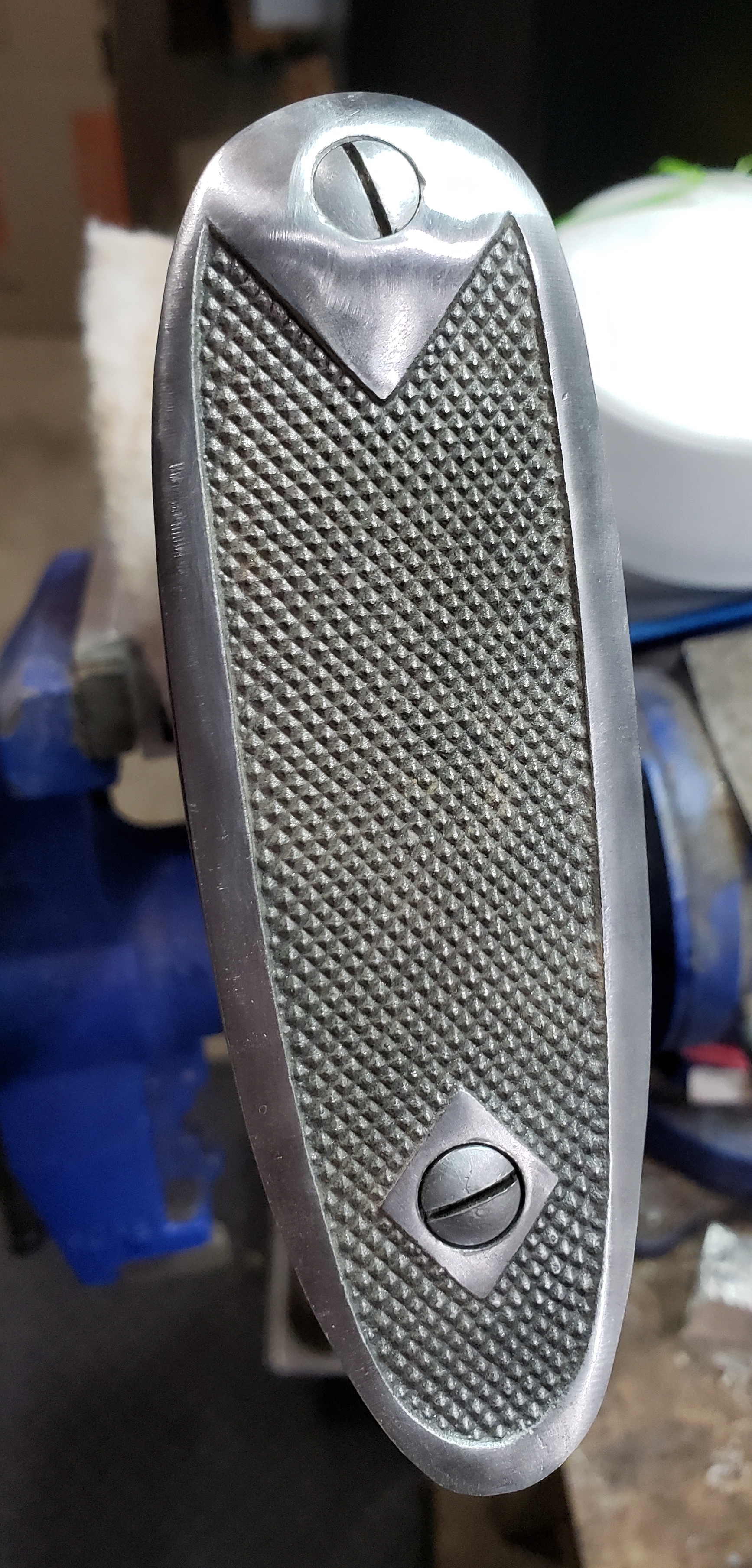

Finally got started on the Boyd's stock after my easter week recess and work trips. Spent an evening inletting the curved metal buttplate. With the widow's peak, screw holes, and toe all perfectly aligned and centered, one side sat mostly flush, the other proud by 20 thous. or so towards the top, then below the woodline at the bottom. The toe overhung the stock by 1/4" but there was plenty of excess border down there to make it work and look even around the checkering. I had to drill out and plug and redrill the holes in the stock. The holes in the buttplate were rough cast, so I had to open up the countersink a bit and clean up the screws to sit in just perfect. Might as well get rid of all the casting pocks too. That was all an evening, and grinding all the excess off the buttplate was another evening. Pat myself on the back and yell at the kids to bring me a beer!

The fit up is ok. I was happy that there is a very even but barely noticeable gap around the edges of the wrist. Not much to do right! Wrong. There is 40 thous. of room behind the trigger guard. Way too much.

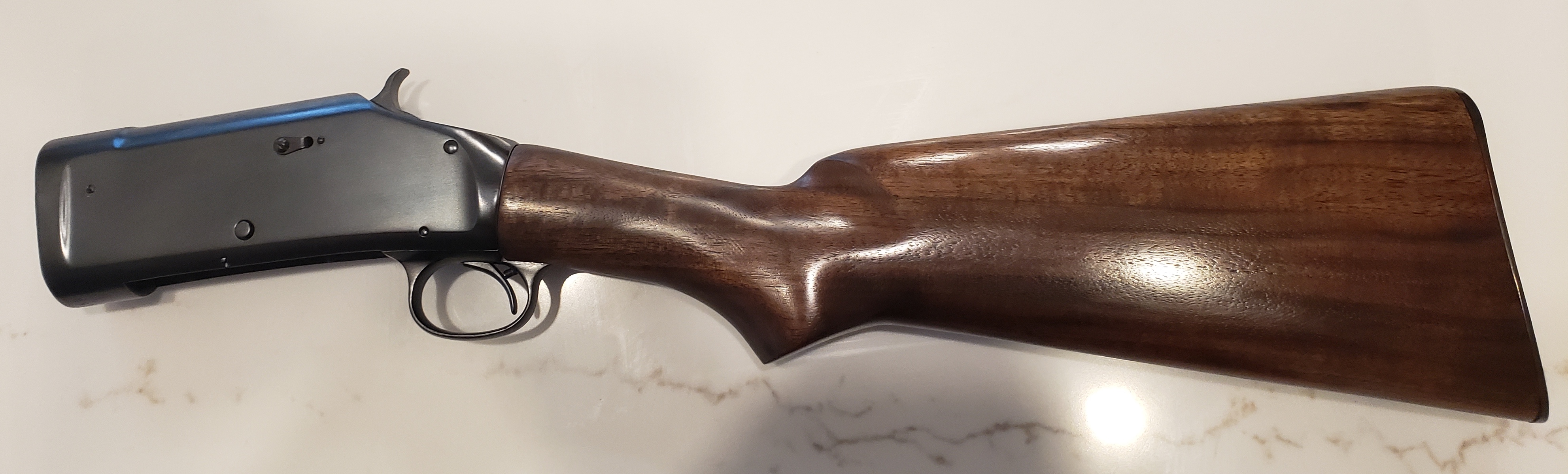

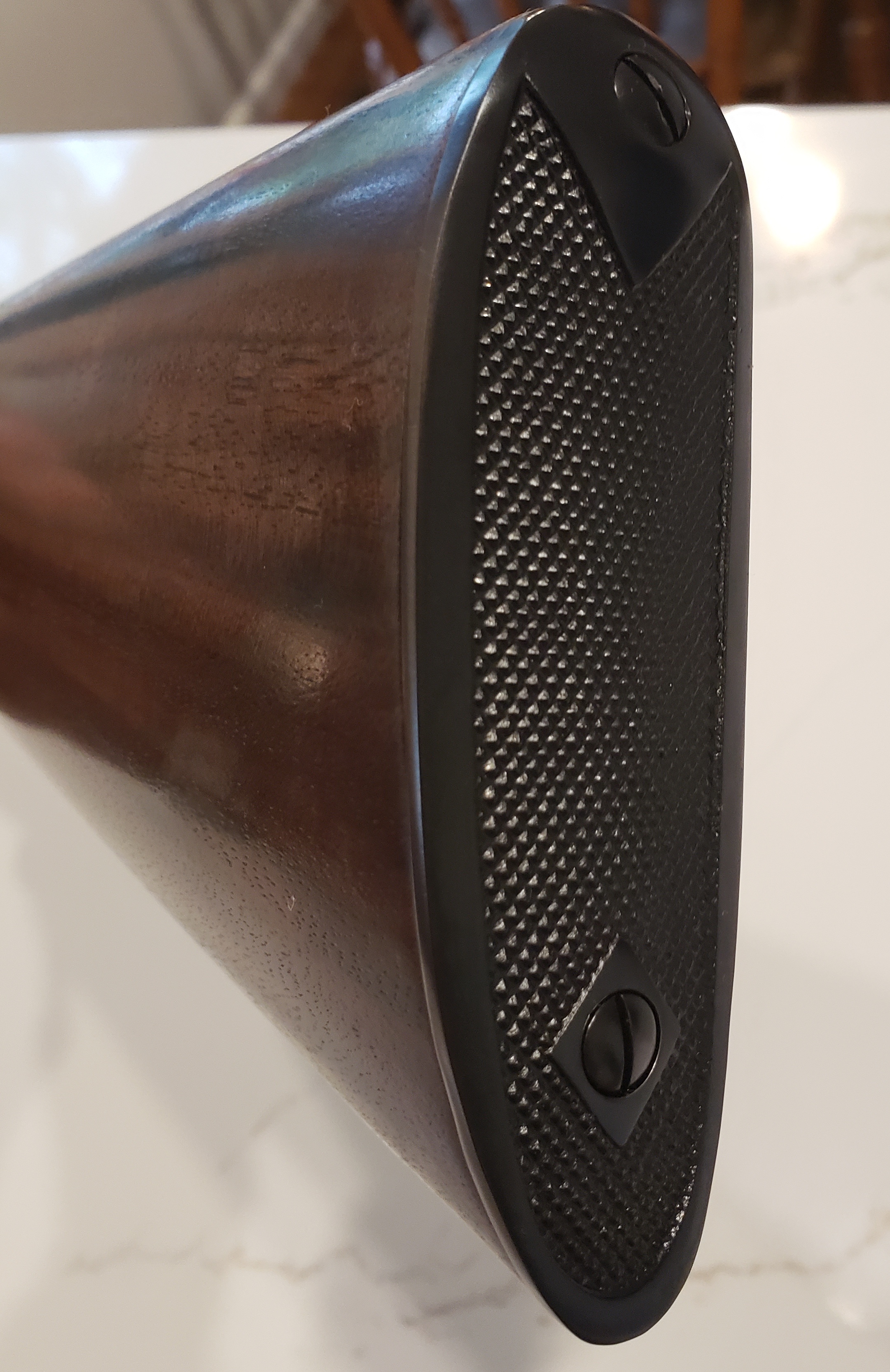

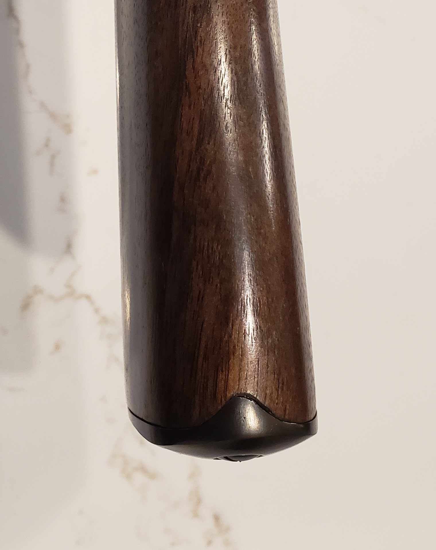

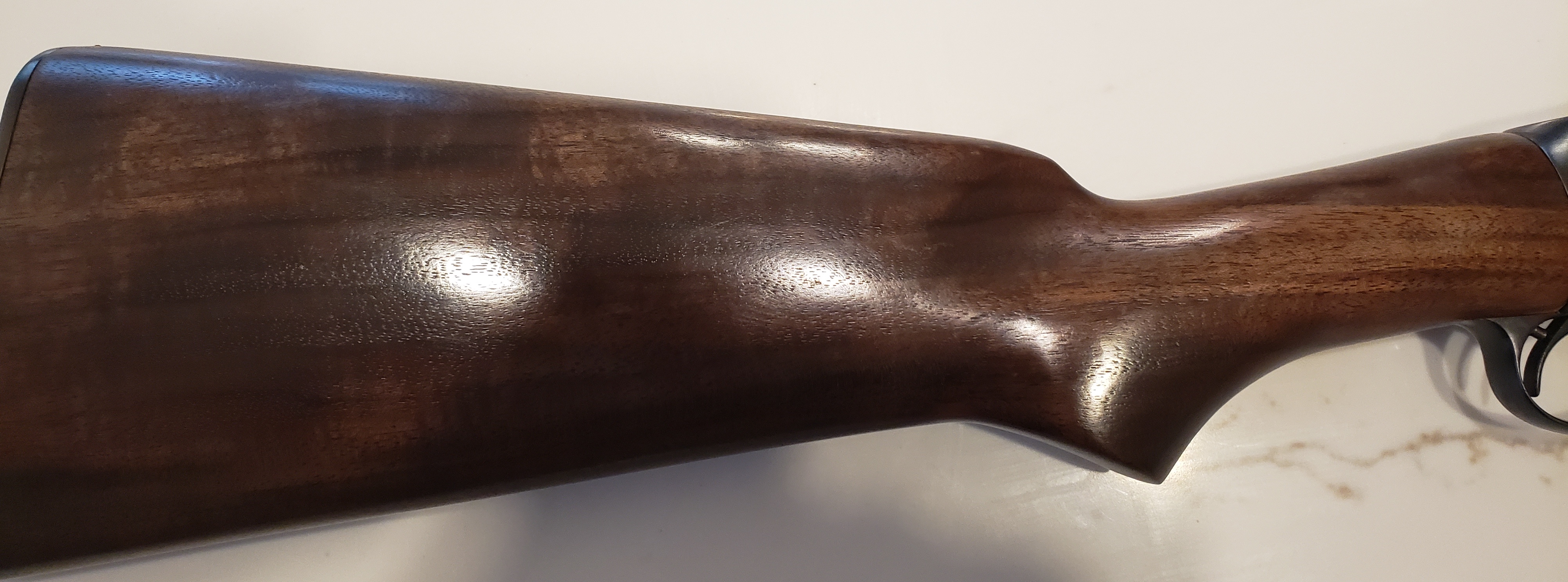

Here it is. The finish is much more satin than the camera shows it. The walnut was lighter than I would have like, but I think I was able to darken it just enough to bring out the American in it - or at least it matches the original forend handle. It will get heavily used come turkey time, so I went ahead and waxed it.
Attachment 131013Attachment 131014Attachment 131015Attachment 131016Attachment 131017

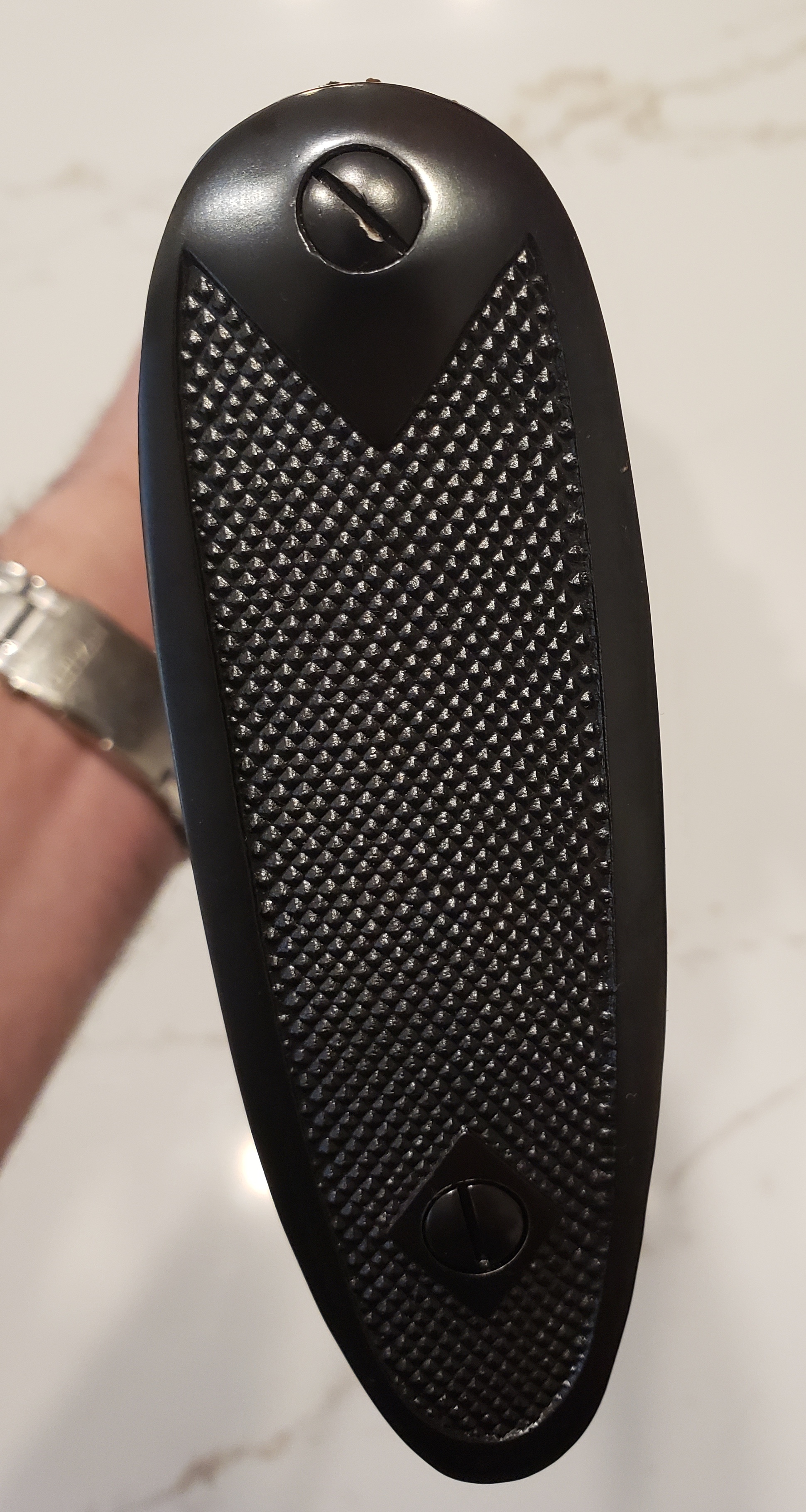

The buttplate turned out ok. It's curved on the underside from left-right. I didn't work it down that far when I fit it, so I may bed the underside center with epoxy to spread the recoil forces towards the center.

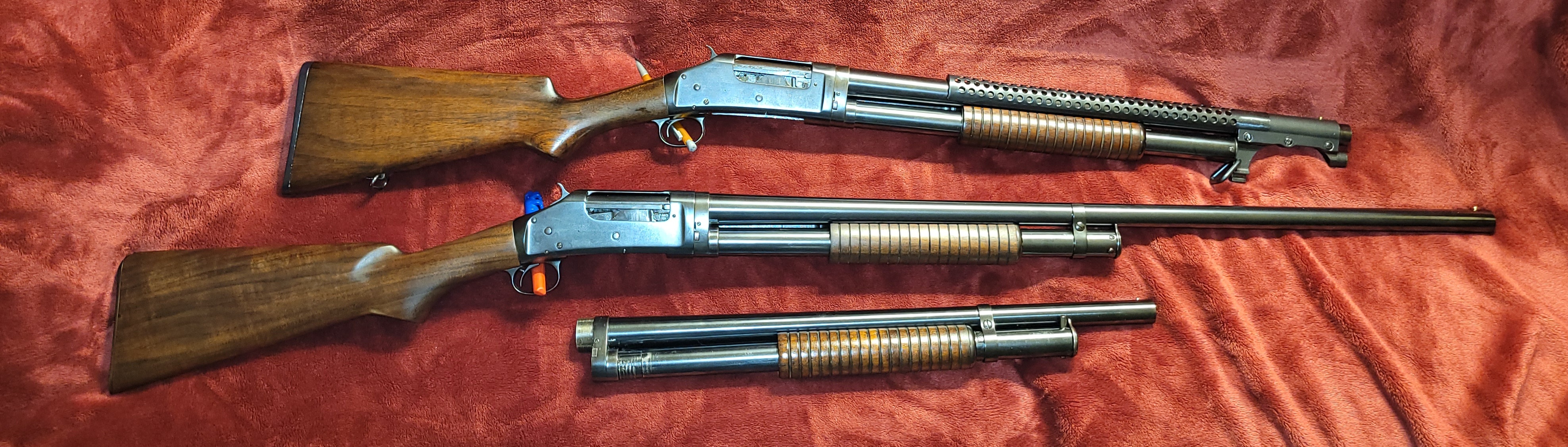

The barrels and mag tubes for this project have been polished and hanging in the shop for ... well since my last post. So I spent the weekend rust bluing, cleaning screw heads, and fitting parts to build the forends. I'm very satisfied, at least with appearances.
Attachment 137249
Here they are next to the trench gun project (Finished the latter a while ago. there is a thread on it here https://www.milsurps.com/showthread.php?t=76435
Attachment 137250
The riot gun forfend is a 20" norinco replacement barrel. New when I got it sans some shelf wear. Its heavy. The extension I found was a bit beat up, as was the mag tube. Took quite a bit of work to get them fitted to work - I did it first. The 30" barrel and mag tube and original matching serial extension fit up with little to no effort - owing mainly to the fact that it was me who removed the original extension. The other bubba slightly malformed when he took it off.
