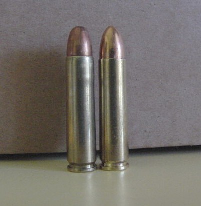

Good point Jim, and I did with the 450.
Here's a picture I took in 2005 comparing an Armscor .30 Carbine cartridge on the left with an LC round on the right. There were a least a couple like this in a box of 50 - I only discovered this when a round didn't fire and I found the bolt hadn't closed completely. The picture is small but you should be able to see the difference in case length - OAL looks pretty close, though. I haven't bought any more of it since, but I have reloaded with their bullets and they work just fine if you seat the bullets slightly deeper. Here's an old thread from the CMP Forum that I saved from about 10 years ago. I'd like to have a box of the Armscor that Charlie found on sale - just to see what the quality is like. After 20 years or so, you would think they would have the problems worked out. One trend I've seen on lower priced ammo lately is excess crimp on rounds that head space on the case. I've seen this on both 9mm and 45 ACP. - Bob

Cartridge at left looks like the snake that swallowed an egg.

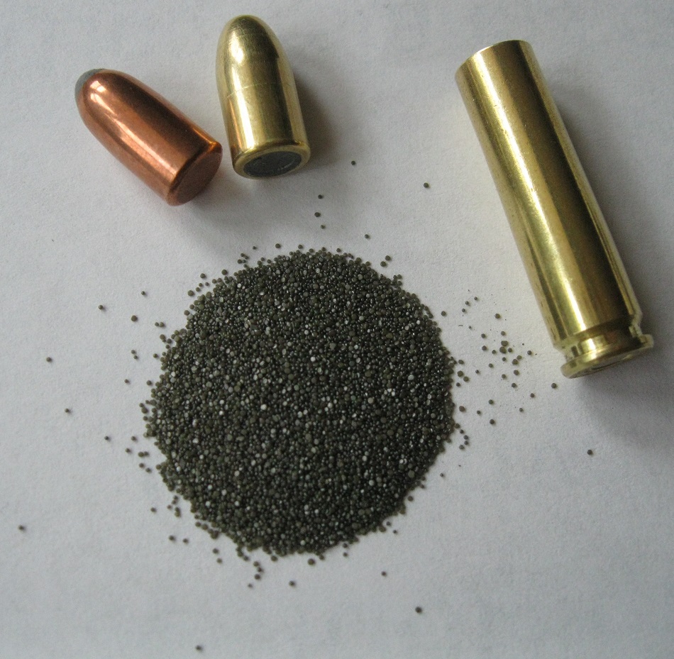

USGI - The 'unfired' Armscor cases measure from 1.284 to 1.288 inches in length.
The 'fired' cases are measuring 1.278 to 1.282 inches.
The powder charge is 13.7 grains.
The bullet diameter is .308 and length is .655". (Same as Hornady)
Fired primers show no flattening or pressure signs.
Attachment 131264
That 'fired' length on the cases is before resizing, right? I'm curious what they measure after being sized - and also how close that powder charge comes to the bullet if you put it back into an 'unfired' case? It sounds like you've got a good handle on the situation, though! :thup: - Bob
