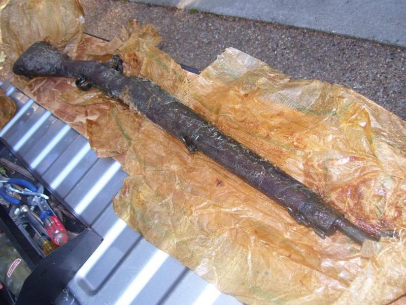

As to DCM direct sales, they DID take place. During the early 1960s, at the time the DCM was selling M1903A3s through the NRA. I went with my mentor at the time to the U.S.Army terminal, Bayonne, NJ. He was a NRA life member, and they allowed him to go through a pile (I mean in a pile) of '03A3s, pick one out, fill out a form and take it home. No charge for packing and handling, as there was none. Cash and carry. I became a member, went through the NRA, got an invoice, sent my money to the arsenal, got shipment from Letterkenny Depot. $14.50 plus REA collect. Still have it. Lost the box.
go to the photobucket link to see the box and after clean up pics
1903a3 BEFORE pictures by Selmalinapilchard - Photobucket
https://www.milsurps.com/images/impo...100_1217-1.jpg
