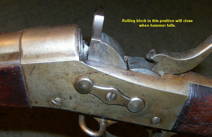

This will result in the case's forward section/shoulder being anchored by pressure, and the case stretching as it tries to stay engaged with the breechblock face as it opens up. Bang! Instant failure just ahead of the web and the head kicks out-and-up off the inclined breech surface. The hammer (which is still released while you hold the trigger back) then moves forward under its mainspring and closes the breechblock up again faster than the eye can catch it.
There is no other way that much of a cartridge head can physically get out and the action appear still appear closed afterward.
And the only way that the breech can open with the hammer forward is for the circular breech locking cam under the breechblock in the picture/video here to be broken/off (hardly likely), on the edge of misalignment (or at a strange engagement angle), or the hammer/breech pins are somehow failing to keep things in alignment. The cam/engagement mechanism/surfaces are massive, though, and theoretical can't fail.

Somebody would need to model this action and determine what force it takes to force the breech block to override the hammer. Because that is what is happening.Quote:
The action is opening. The breech block is forcing the cammed surface of the hammer to move. I suspect there is enough spring in the action for these to occur. The breech block forces that hammer cam back, then the breech block opens, case head comes out, and then the hammer spring pushes the hammer and breech block closed.
You can't see it because it is happening too fast for your perception.
Under load, with a high speed camera, you would see things moving. Actions are not static, under load they stretch and move dynamically.

The breach block of a RRB cannot force the hammer back in any way. Once the hammer has progressed to the point where the breach block is above the curvature of the hammer, the block can only move back if the hammer is retracted. There is no cammng surface.:cheers:

I suspect that the sequence of events that allowed the case head to escape was -
1. The over-stretched case separated at about peak pressure and moved rearward at high speed, unrestrained by the now-detached case body's friction with the chamber.
2. The primer, as part of the head, struck the firing pin with sufficient force to drive the hammer back enough to clear the breechblock's locking surface. Finger still on trigger kept sear from engaging.
3. Residual pressure could then blow the block open enough to allow the case head to escape.
4. With the case head gone, no internal pressure remained, allowing the hammer spring to return hammer and breechblock to the normal fired position.
https://www.milsurps.com/images/impo...partopen-1.jpg
While this seems a highly unlikely string of unusual events, it's the only way I can imagine the case head could escape unless some part of the action were broken, missing, or deformed.
