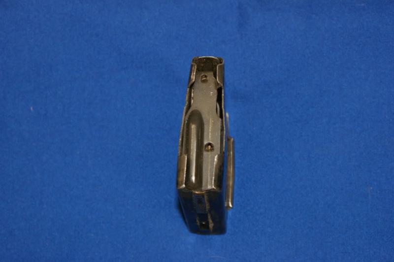

Finally,.......................................... 2A magazine pictures
https://www.milsurps.com/images/impo...DSC00189-1.jpg
https://www.milsurps.com/images/impo...DSC00190-1.jpg
https://www.milsurps.com/images/impo...DSC00191-1.jpg
Sure wold be nice to have a Knowledge Library article developed and written as a collectors guide to Enfield Magazines ... ;)

What, nobody has any pics of a single-stack MLLE mag, or all the variants of the .22 cal mags, or the elusive 20rd mag? How about the carbine 5 rounds mag or the BSA Lee-speed sporting rifle mag?
For .22 mags, the most commonly encountered are the No.2MkIV mag which is a standard SMLE mag with the guts removed and a "22" stamped into the side. After that, you often see the CNo.7 mag with "22" engraved on the side and a loading platform for the .22 shells (single shot) inside the hull. Outwardly, it looks like a No.4 mag. There are, of course, other types but they are not likely to be seen in the wild.
Closest I can get to a MLLE single stack is a 30-40 Krag caliber 1899 Rem-Lee mag; I keep wishing though! Dunno iff'n I have a .22 marked mag shell, no fancy 22lr mags here:crying:. Don't know if I still have camera priveleges after last weekend's flog!
