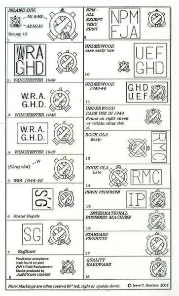

From page 13 of J.C. Harrison's book, it looks like #14:
https://www.milsurps.com/images/impo...ab7911cp-1.jpg
...and the center of the ordnance wheel is 9.5 cm (about 3 3/4") forward of the oiler slot.
Unfortunately there are many mistakes in Harrison's book. Number 14 has long been recognized as an error and is not found on legitimate RMC stocks. It's pattern has been duplicated by the fakers as well. The vertical RMC cartouche above posted by Brian Q, would be correct. RMC made many stocks for different prime contractors. They were known for their stock making expertise. I have an early QHMC with RMC in the sling well and the larger crossed cannon acceptance stamp on the right side next to the I-Cut.
dbarn is right on about Harrison having many errors. But it is still a reference so it was added long ago to my library. Maybe whoever is making the stamps found it easier to use a mylar template, who knows.
What we do know is BrianQ posted the correct marking.
