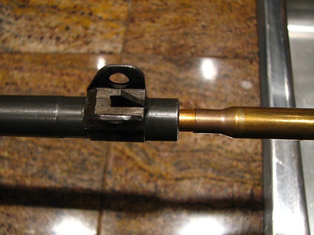

in different light. Do you still think this sight has been removed? Owned it since 1969.
https://www.milsurps.com/images/impo...00457a_b-1.jpg
The stripe in the picture posted by mpd1978 in post #13 was caused by the front sight assembly fixture and is found to varying degrees on most original finish Inland carbines. Including those that have never had the front sight removed.
The front sight in DaveHH's post hasn't been off the barrel. The marks were probably caused by something banging into the side of it. The grenade launcher and recoil check create different marks.

I agree with Inland44's theory. It looks to me like a tight fitting front sight would burnish the sandblasted area when installed. The area of the barrel directly under the key slot in the sight wouldn't be burnished because there is no contact with the sight there, and it would probably look different in that area after parkerizing. I've seen this same appearance on a lot of machinery parts where a gear or sprocket with a key slot has been pressed on. - Bob
Just because there is some crud built up around where the sight meets the barrel doesn't mean it hasn't been off. I stand by my initial assessment that the sight has been removed. I've seen that damage on a lot of sights that were removed without the removal tool. There really isn't any other explanation for that damage.
Bill and I are talking about the slight flaring on the rear of the front sight in post 12. They are beaten off with a brass drift and that's the damage that occurs. 1969 isn't that far back. I remember it well. So, it was done before that.
