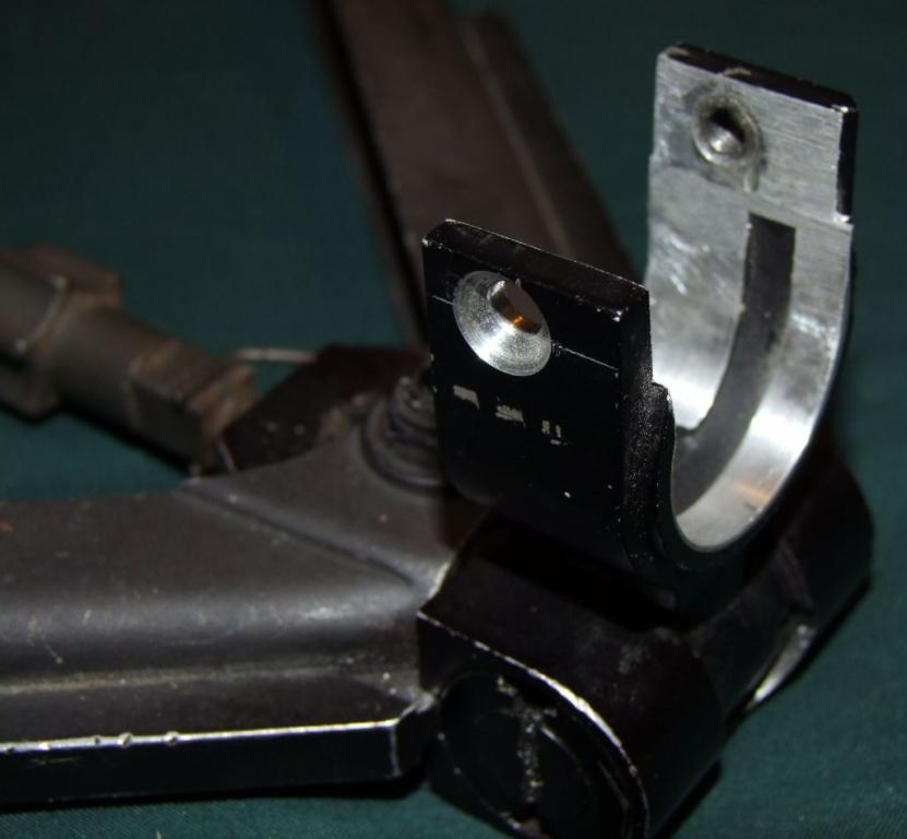

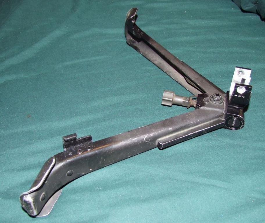

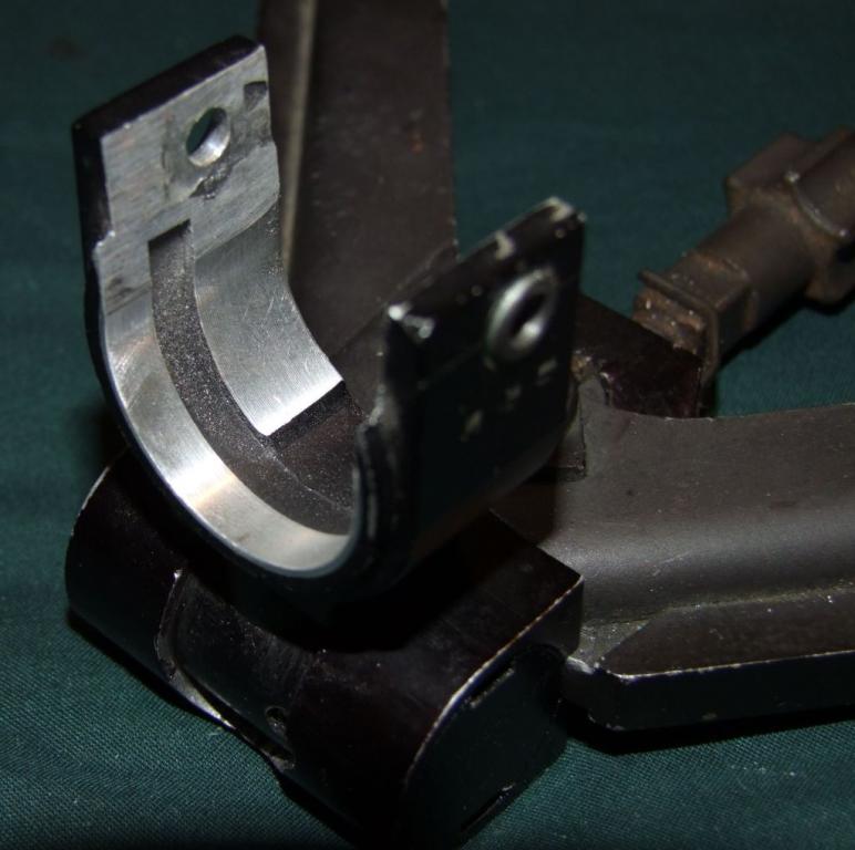

Basically I've done what tankhunter said except I have a machinist mate who kindly threaded the hole on the left hand side of the bracket, bipod. I used the long handguard screw for the L1A1 wood handguards to secure it all.
You need the following:-
L2A1 Bipod (1005-99-964-1258)
Adaptor, Bipod (1005-13-010-0631) (if this type isn't fitted, it has straight sides and needs to be modified)
Screw, Handguard (1005-99-960-2101) Long L1A1 Wood Handguard Screw
https://www.milsurps.com/images/impo...2Bipod01-1.jpg
https://www.milsurps.com/images/impo...2Bipod02-1.jpg
https://www.milsurps.com/images/impo...2Bipod03-1.jpg
If you don't drill-out the thread in the right handguard, you won't be able to tighten up the bipod onto the handguard because the screw will only tighten into the handguard and not the bipod bracket.
