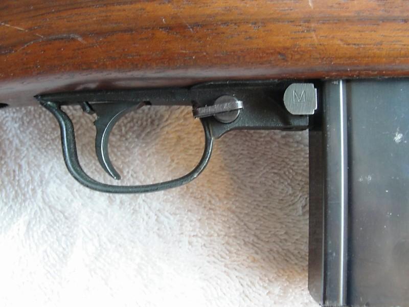

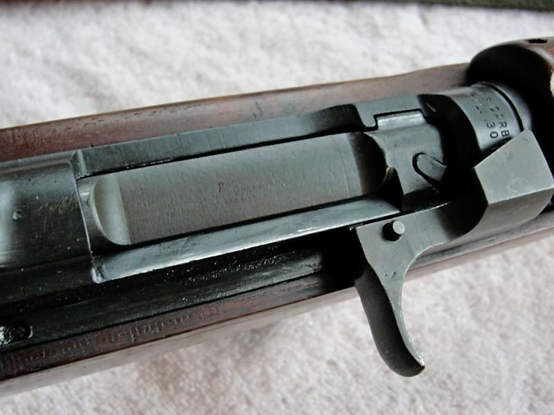

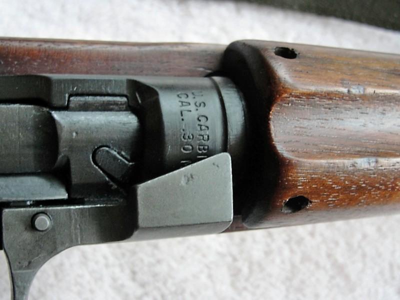

Trigger housing was made for IBM. The sear for Standard Products. Hammer late war/post war replacement. The bolt should be marked on the end of one of the lugs. I would also suggest a punch to push back the dimple that could be retarding the funtioning. I would do this first then take the carbine to the range to check funtioning AFTER you clean it that is. You may not need to replace the spring if it works like it's supposed to.
Please clean it.....
CH-P777
I cleaned it. That's what I was in the process of doing when I took the pictures. I realize I should've taken the pictures AFTER. But I didn't. SORRY!!! Thanks for the replies on this!!

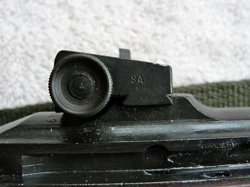

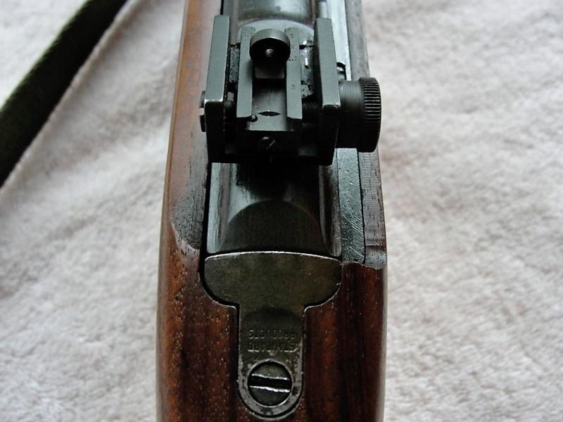

The tolerances of this carbine sure seem a lot sloppier than my Dad's inland. Everything just seems to be looser. When I look at how my Dad's bolt is in reference to the receiver, there are nice clean, consistent lines. Or I should say the dimensions between the receiver and the bolt are much more consistent. And mine seems all, inconsistent. And the trigger group fit is so sloppy compared to the inland. Ugh. So, I'm not sure how much either of those things make a difference, and yeah, I wish I was close to one of you experts on this board. I just think my Dad's has a better chance of being a more reliable weapon. But maybe I'm wrong. His seemed to have hiccups too, I just never shot it as much as mine.

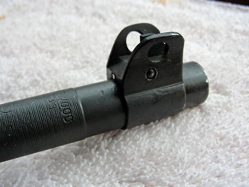

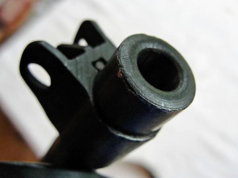

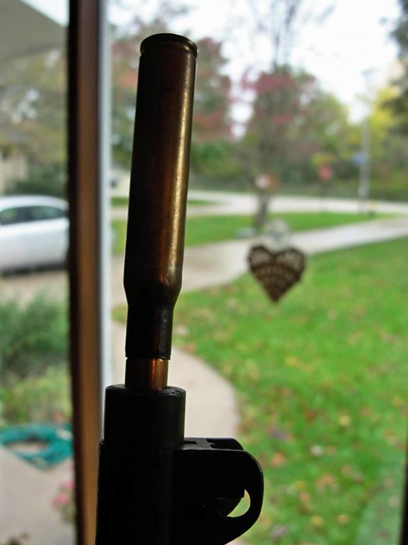

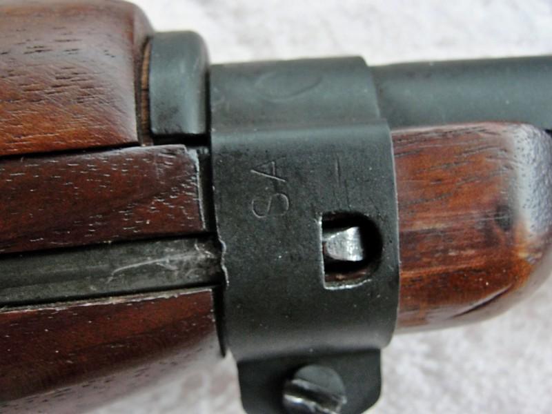

I think your canted front sight is an optical illusion based on the warped sight relief in the hand guard. Look at the pic you posted and cover the center of the pic including the hand guard with a piece of paper. Now compare the sight to the back of the receiver, and it looks pretty good.
'I don't recall saying I had a problem with elevation when shooting. Other than the fact that to zero, it had to be raised up to 200'.
That is a problem indicating the front sight post is too tall.
'I've been hesitant to take the front sight off for a couple of reasons. First off, if I order a new one, it might be expensive, and it might not be any better than the one I have.'

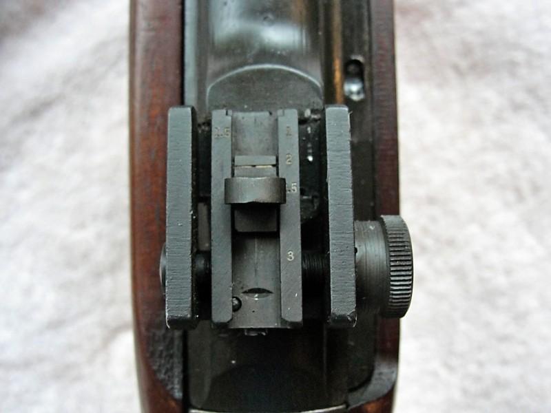

You don't remove it to lower the sight blade, you file it down at a slight down angle to the front. Do this at the range, with the rear sight on '1-1.5'. Continue until you are maybe 1" high at 25 yds. While shooting, adjust your windage to the vertical centerline. Later, adjust the little movable indexing plate on the back of the sight to meet the index line on the ramp. Now take it to the 100 yd. range and adjust the windage a little if needed. You should be about 6" high at 100 in order to make the other ranges on the rear sight meaningful.
