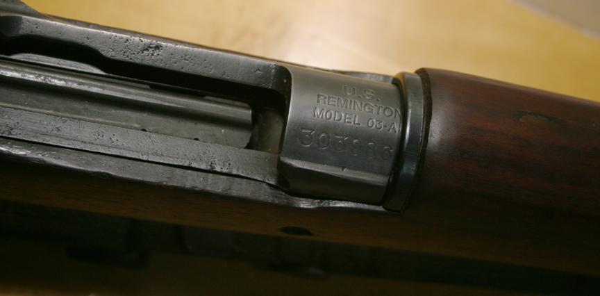

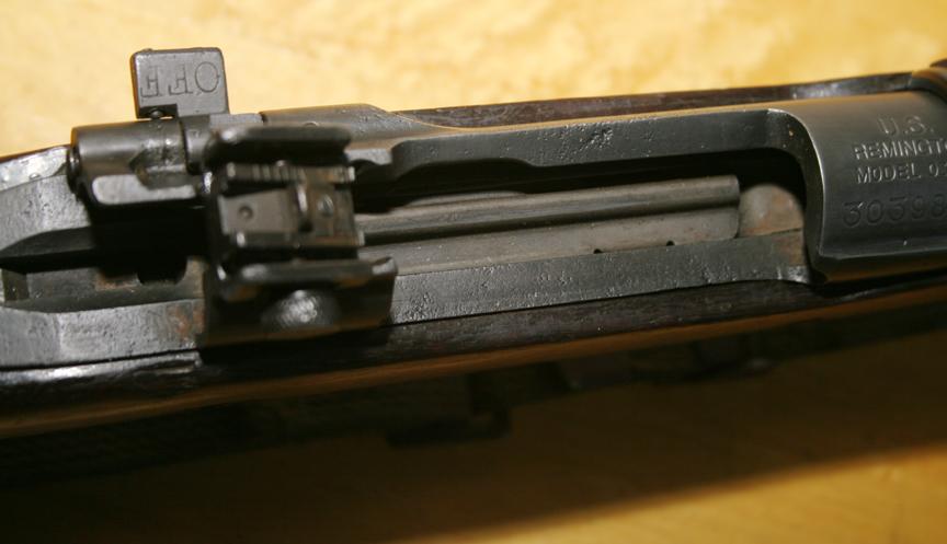

Attachment 39343Attachment 39344heres a pic of a 1903A3 thats close to the serial of the one you pictured, compare the size, index, and font. also notice the guide line for the handguard ring is missing on yours.

I just sensed an immediate feeling that I was trying to pass off something that was not what it was supposed to be. I've seen fakes, numbers out of line, not even in line with the stamped numbers above, that kind of thing. I know that's sad but common. What I might suggest is a sticky that details the kinds of things to look for and photos of fakes. I just felt mine was odd in that the same font used for the Remington A3 03, which looks original to me, was used in the serial number so it seemed possible that somewhere along the line it was re-stamped. Arsenals do some odd things from time to time. I'm not trying to say this is not fake, it's just difficult, it seems to me, to call that, with no question or regard, a fake so quickly. The internet requires a thick skin, mine just go real thick quick.

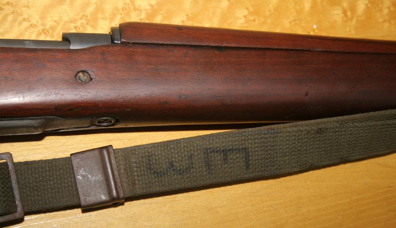

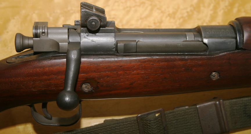

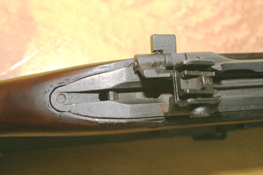

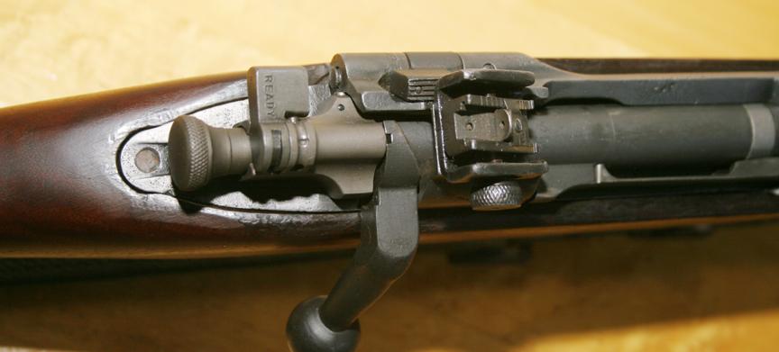

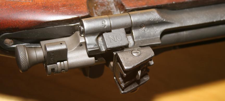

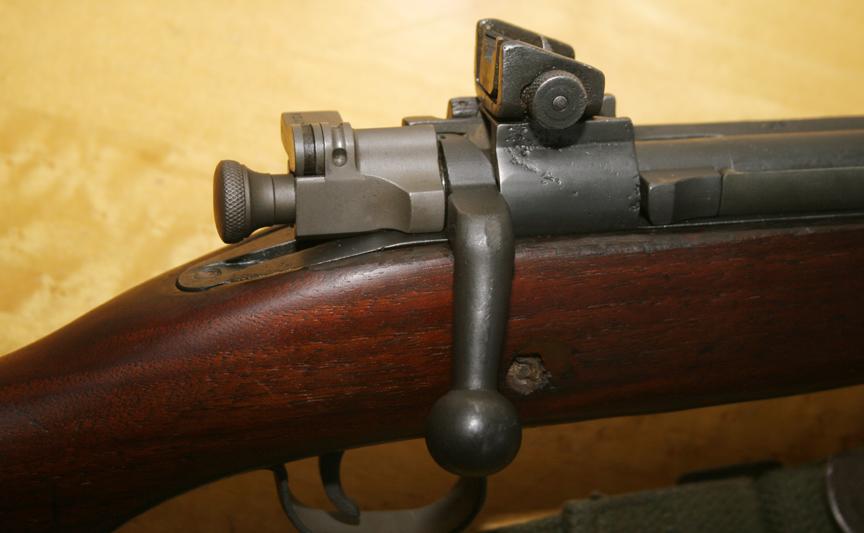

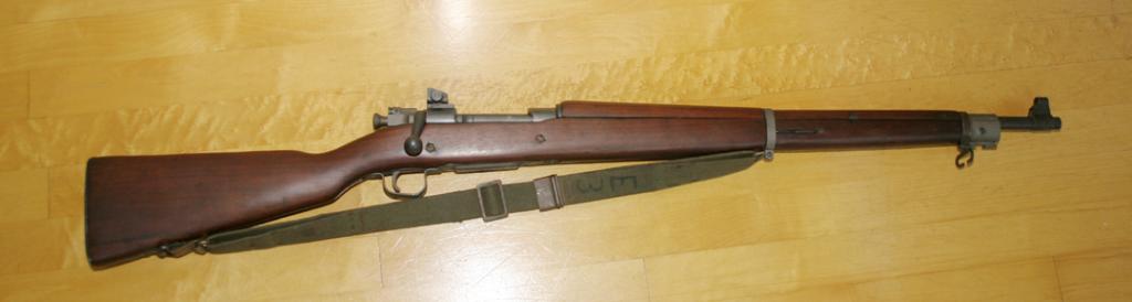

I'm posting some photos with the rifle back together, I wanted to take everything apart for a closer look. I found the R stamps in the right places, lots of pitting, you will see it below, and the magazine box is really quite pitted. Even the new barrel, which as I said checks out as nearly new, shows some light external pitting. I assume the rifle was stored in a higher humidity as the barrel is late war, almost post-war.
If you know someone well on the forum, you can take some liberties with what you say as they know you and realize where you are coming from. Nobody knows me, you don't have any clue about me and I realize that, but I always jump in on posts I moderate that seem to be heading in a direction where a newbie might take things the wrong way and try to create a long-time member out of someone who might be offended and just walk. I think the goal of all forums is to create a community of trust and respect, it's easy to do, easier to do the opposite. Getting off my soapbox now.
Lousy photos but maybe they will offer some more information.

based on the new photos, i can see that it is a Genuine military A3, what i would say by the pics, is that it had heavy water or fire damage at some point, and likely thats when someone engraved the markings, including the serial number. as you can see compaired to the pictures i posted, the indexing and number font is not right.
with the heavy amount of rust damage, the receiver ring should have damage as well, and likely did before it was modified.
none of my post were or are an attack on you, only and observation of the rifle.
legality asside, i would be worried about safety on the rifle, and would recomend a rockwell hardness test. rust from flood or fire damage, can effect the hardness of the steel.
one for sure fix that iv done on other rifles modified in the same way, is to buy another receiver, and have all the parts installed on that , then destroy the moified receiver, or make it go away.
you can get a recovered drill rifle receiver on GB or other auction site for less then 200.00 if you shop.
