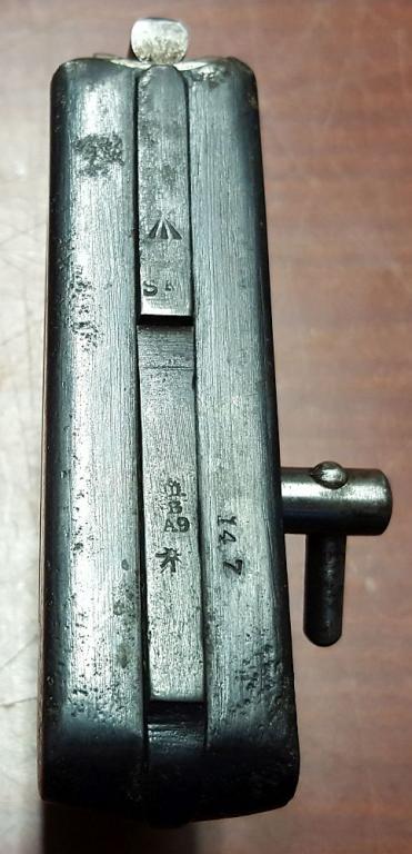

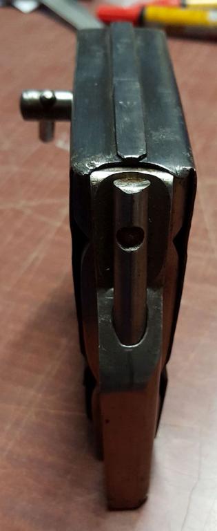

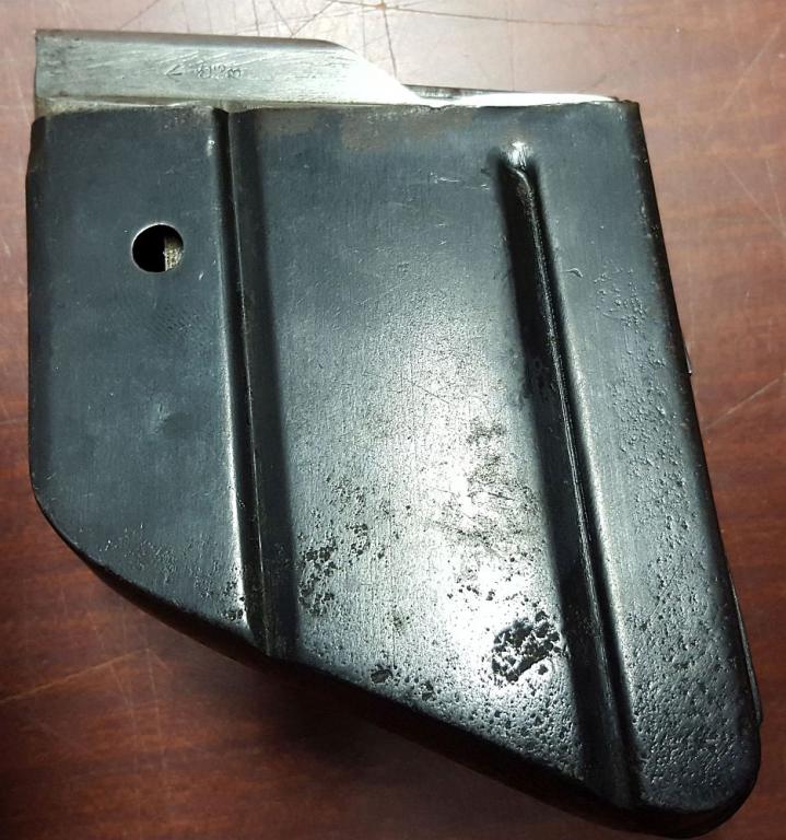

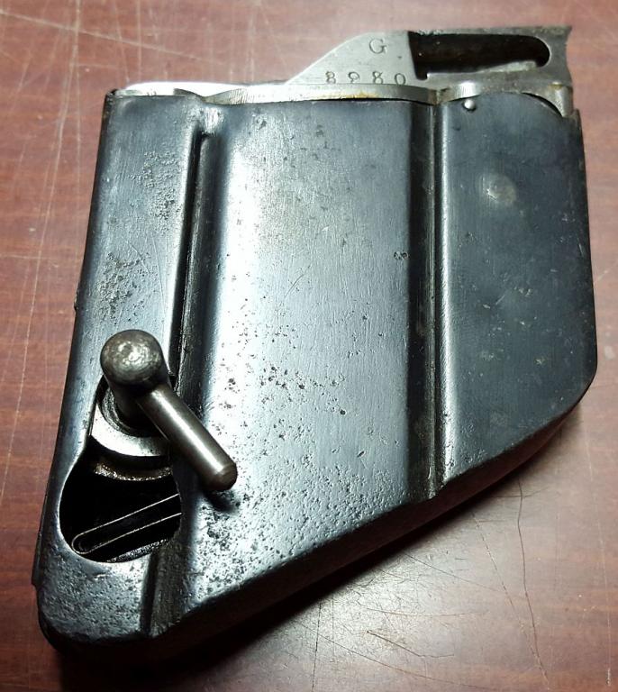

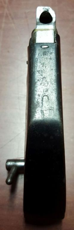

At the moment, focussing on putting a standard .22 magazine into a housing that has a push-rod similar to the Parker Hiscock. Thinking of using a 7.62 Ishapore 2A1 magazine case - this fits the No 2 Mk IV and has a removable bottom plate, so making the internals easy to get at for modifications.
