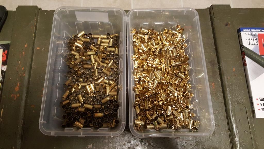

Just did a few hundred 45ACP. Neglected to take a before but just threw in 100 .308 and still have some that need a proper pin cleaning so hope they will show the difference. I think the .308 were cleaned in a walnut shell vibrator and they were anything but well done. IF they do show a discernible difference will post pictures.
The dirt that came out was unbelievable, absolutly filthy water and little bits of ????. The huge difference is the inside of the 45 is shiny clean.
Just for you Jim. Think the difference is pretty obvious.
https://www.milsurps.com/images/impo..._zpsyjvt-1.jpg
Nice job I am looking at 1 ACP case I can just make out the primer is in Rt side against the side of the container 1.5" from the bottom.

Cinders, the 45's were not worked at all so need to be deprimed etc for the next step. We just wanted to try to see how good it was, am impressed to no end.
We just finished 100 .308's and they were already resized and trimmed to length and they are just as good as the 45's. The big thing is the inside of the cases are clean which you just don't get using a dry medium. From now on I will deprime, then clean then resize and trim to length. A clean case will be easier on the die which is not a big deal but helps.
The one negative is the pins occasionally will stick in the flash hole, not much of a issue in .308 but easier in a .223, I was told rarely you will find a .308 with 2 or 3 stuck in the flash hole, too large for a single pin to stick in it. There is a great magnet designed to pick up the pins and a pull of the handle and they are released. Also a "basket" available to rotate them in using clean water to rinse off the soap/lemi shine used in the tumbler.

Yes I agree, it's about what I expected to see. There's a man here uses SS pins too and I saw his brass at his shop. It all looks new. There's no better description.
That's what he uses to, this friend that uses SS pins. It's the way to go. You can put the pins into a ziploc bag by turning it inside out, put the magnet inside and then use it. Turn the bag right side out and release the pins. That way they all start inside.
