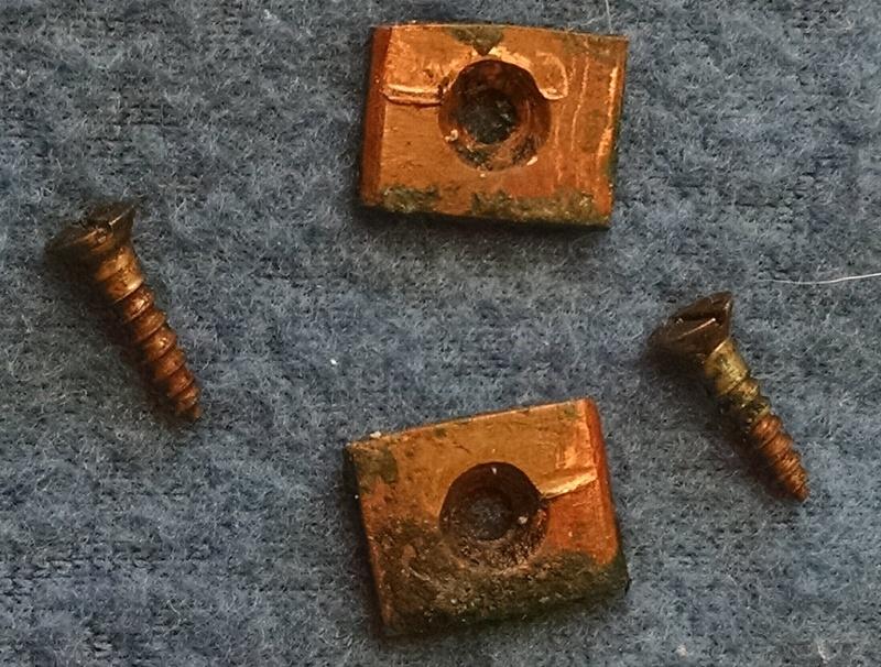

Sons thread and photos do show the WIDER copper plates but this amply illutsrates a couple of points that I couldn't mention because I don't have a fore-end handy. The wider plates ARE wider but is that simply because if they weren't wide, you'd never(? or hardly without totally weakening) get a wood screw countersunk head into the plate! And no matter how you put it, the rearward loading in that situation goes straight down through and into the wood where the drawers sit, tilting the copper block as it does so.
I had a funny feeling that this would run as soon as I put pen to paper.
Here's another question chaps........ How do you repair a copper blocked fore-end when there's end float? Bin it and get a new one, put thicker copper blocks in place and plug and re-screw the screw hole or just wood patch in the usual manner observed amongst Armourers
Peter to your first question, I would respond, when properly fitted, there's no allowable movement between action and wood, so the plate can't tilt.
Second question, I'm interested to know also if there is some kind of armorers instruction to repair end play. To be honest, I haven't come across any coachwood forends with recoil plates that presented any noticable end play with the action. I'm inclined to think the harder copper plates almost completely remedied the problem of wood compression from bruising directly behind the bearing surfaces.
Ah, but we're not talking about when the fore-end is nicely fitted with plates. Then of course there ISN'T a problem. We're asking about when end float in the taper between the butt socket and drawers takes place.
The NZ Army repair at the huge Base workshop facility where I was based* was to remove the fore-end, remove the blocks and screws, simply machine out the worn drawers, wood patch, re-fit and send back out again or return the weapon to Ordnance. Exactly as we, the NZers, Australians et al had been doing for 40 years BEFORE the introduction of copper seating blocks and we've been doing for 70 years since on No4's. Same meat, different gravy of course. Indeed......, Son has shown photos of such repairs
*I'm just telling you what my boss told me and as I also mentioned, while there were some old No1's still doing the rounds they weren't something that I was working on. My job was war preparation in-inspection stuff

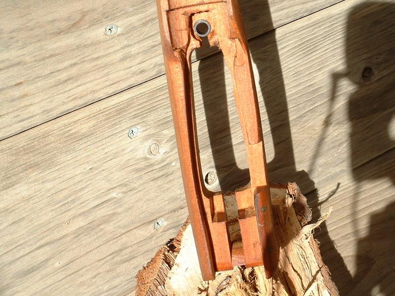

1 Attachment(s)
I have a foreend somewhere where the recoil plates have turned in toward the center pivoting around the screw just as Peter suggested might happen. That particular foreend is well and truly drenched with oil that has probably run back from the barrel when over oiled and racked upright. The coachwood has turned into soggy mess just like the worst of the walnut ones we have seen, allowing the part supporting the inside edge of the copper plates to compress. Of course, once any movement is present, the damage gets very bad very quickly.
I would suggest this is avoidable, and therefore the exception rather than the rule with well kept, tight fitting coachwood foreends fitted with the copper plates.
As for tightening them if they do get loose... I cannot say I have ever came across any that were loose that did not show a good reason for being loose. Tell-tales like the square in the tie plate spread and burred from having the butt screw moved while the foreend is attached. This spreads the tie plate, and cracks and spreads the back of the foreend, stripping the grip of the threaded cross wire at the back, allowing the foreend to spread freely and loading the copper recoil plates more toward the inner edge as the gap between them is opened. The draws cracked out along the screw holes- pic below.
I have, on a foreend I have fitted plates to (and didn't get right first go), used shim material behind the plates to get them to even tension again. Another I did was on a H barreled range rifle that looked to have had the foreend removed by pulling down at the front first instead of tapping off at the rear. Luckily the motion seemed to only compress the draws slightly and few thou of shim each side tightened them up.
