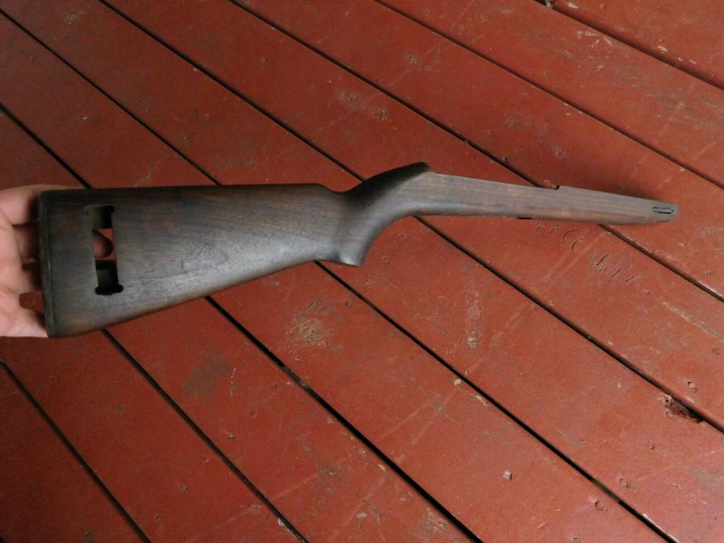

That stock is really nice. The stock on the rifle we have been discussing has the oval cut. I wish it had the "I" cut like that one!

Finally picked it up today (went on Saturday but the State of California had a computer glitch that delayed everyone getting their firearms for at least 1 day past the 10 day limit). It appears to have many original parts but also some mixmaster parts (top handguard marked S-HB, Standard Products op rod, type 2 dogleg hammer). Other than that, all parts match what should be there. My main question is the stock. I don't want to mess it up. Can anyone advise if they believe it has been refinished? The overall gun appears to be in really good shape.

What is the stock marked in the sling well? I don't see an acceptance stamp on the right side of the stock.
He's already told us about the markings in earlier posts. I would say it was sanded and refinished during a rebuild at one time or another. I have a six digit Inland (476K) that I believe has the original stock. The wood is a bit higher than the butt plate and yours seems about even with it. I tried to make a composite picture with your stock and mine. Didn't turn out real well, but you should be able to see what I'm talking about. - Bob
It is marked "OI" in the sling well. I think it has been sanded and refinished also. The cartouche that should be on the right side is gone and it just seems too smooth.

I just did the same comparison with my Underwood which I am 99% sure is original and you are correct, there is a noticeable difference on the edge along the butt plate. Based upon the info, I know what today's COVID19 lockdown project is going to be. The pictures were a big help.
