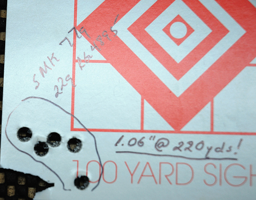

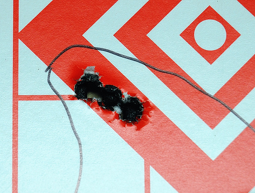

K8 Target Match
220yds!!
The first group has a weird flyer below the three. Trigger slipped.
Who says ya can't shoot 77s from a 1:9 twist barrel?
