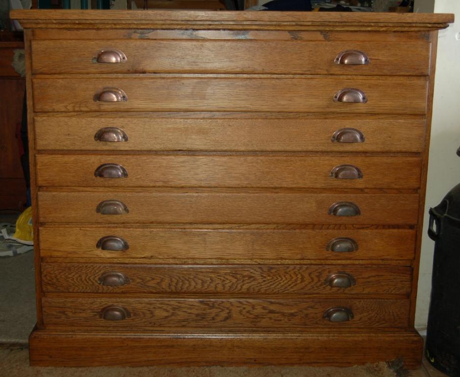

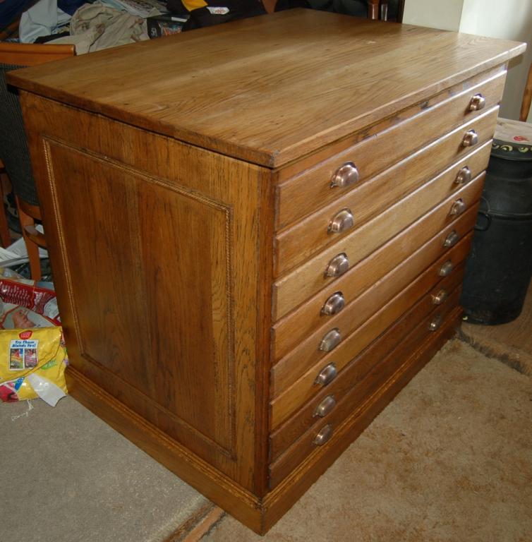

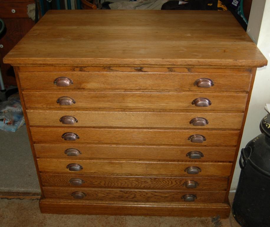

I was busy today and stripped the remaining finish off and coated it with Teak oil, a process I will probably never do again. But it looks nice. Please excuse the surrounding mess. It's not trash, it's bird seed.

The top did not turn out the way I want it so it will have to be redone at some point. There are half a dozen or so light spots which may be from sanding or just the finish not absorbing the same.
Outstanding piece. Photos loaded perhaps?
I'm not anywhere near ready to load it yet. I have to clear out the space where it is going and reinforce all the drawers. They need disassembled, refitted and glued and a new back extension put on each one. As they are now, they are out of the groove in the front and nothing in the rear so they can sag if loaded heavily. Probably another all day project setting up specialty tools. If I load it before I do that, I'll never do it.
Could you reinforce the drawers along the outer edge & down the center with tracks & rollers?
The drawers are built pretty heavy as they are. I have no doubt they will hold the weight. It's just that they shrank and the previous owner never addressed the issue. The bottom fits in a groove on the sides and front but not the back. They have all slipped out of the groove in the front. I'm going to move them back in and glue them and add a rear that also has a groove. The bottoms are nearly 1/2 thick poplar. I don't want to alter it too much from original either.

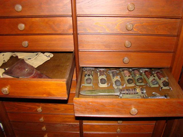

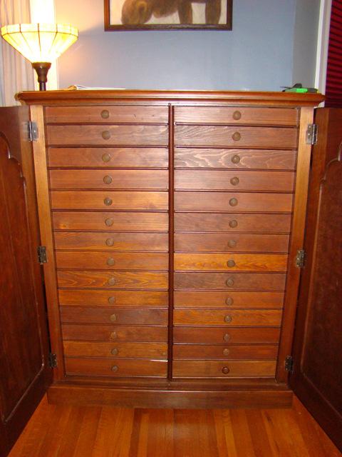

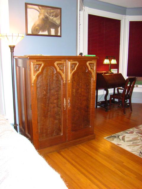

Congratulations! You definitely have a gem. I spent years looking for a map chest for the same purpose. I finally found this in Indianapolis. A downtown architectural firm was moving and this did not fit their new modern decor. I was told it had been with the firm since its beginning. My long blades do lay at an angle but that's ok since I don't want to overload the drawers. Again congrats on an excellent purchase at an excellent price!!!

That's a nice type also. Never saw one like it before.
VERY classy!
Beats the rubbish sold as "modern" furniture.
