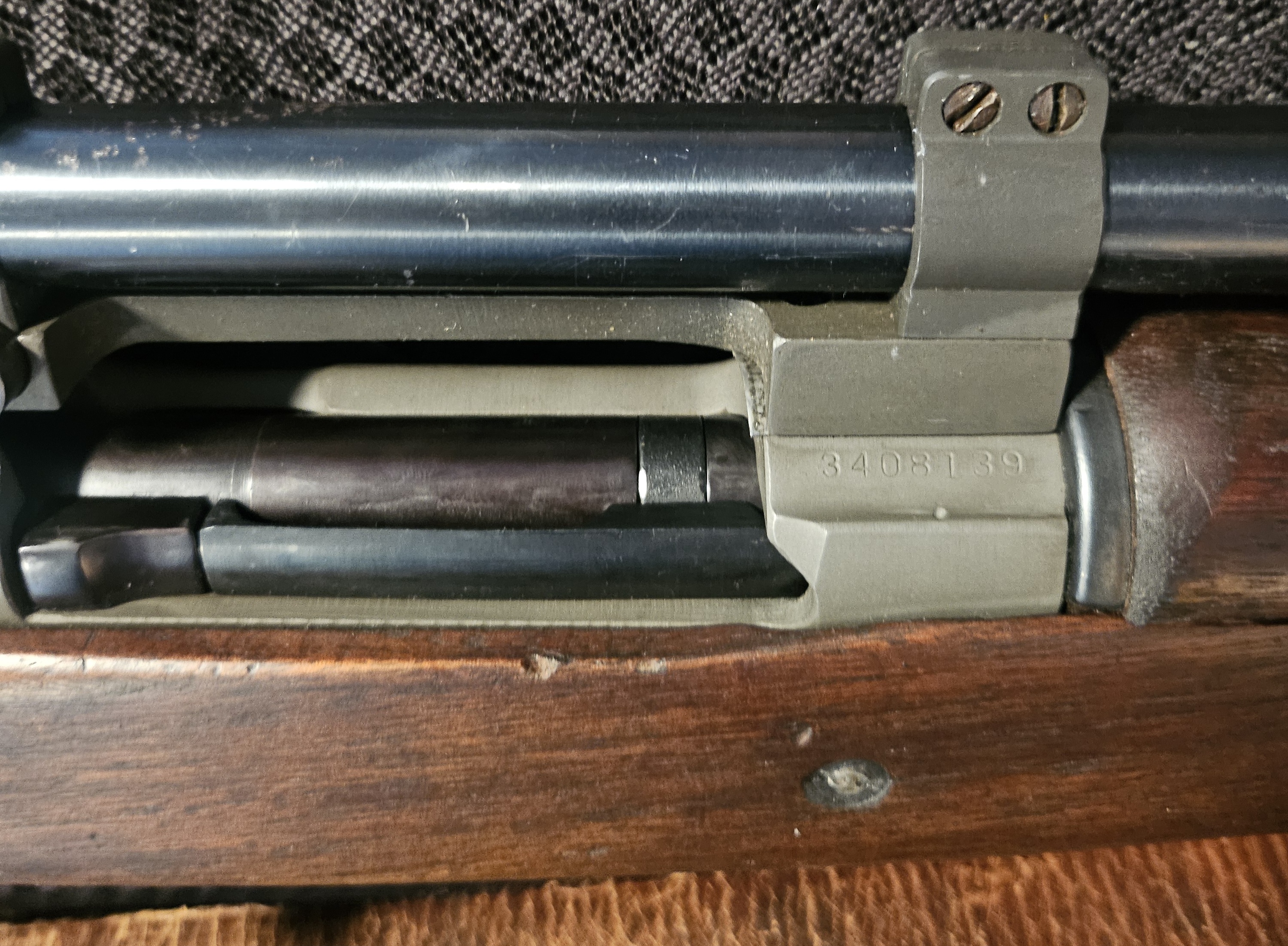

looking at those pictures, likely original bolt, and the rust pitting, in the locking lug area is why it failed headspace, a replacement is needed for sure. there is a dealer in France and another in Greece that may have a genuine A4 bolt.. shipping a bolt to EU, could be challenging, i know i wouldnt do it. the stock you have pictures appears to be a newly made reproduction made in Italy, fitting can be challenging,

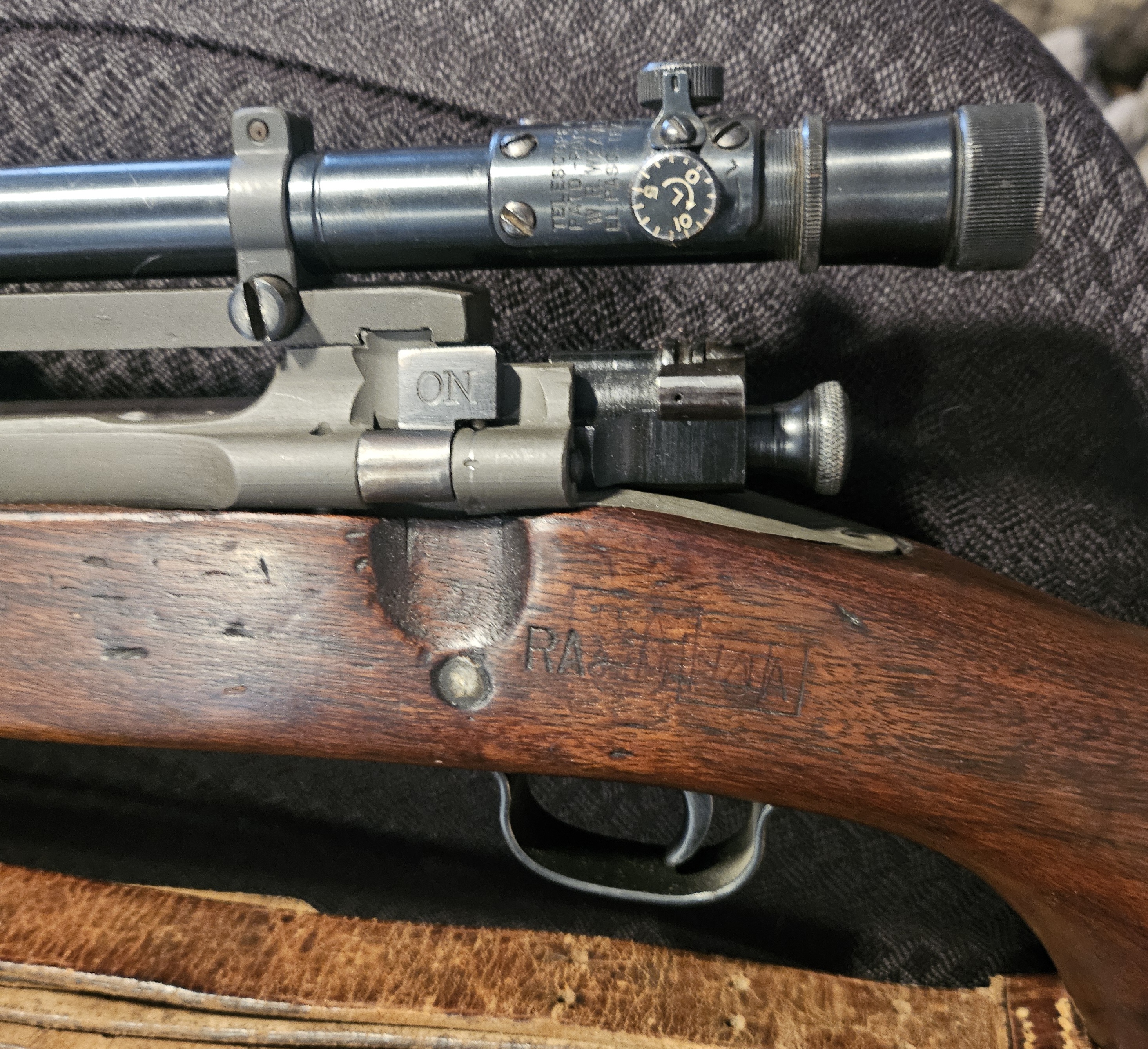

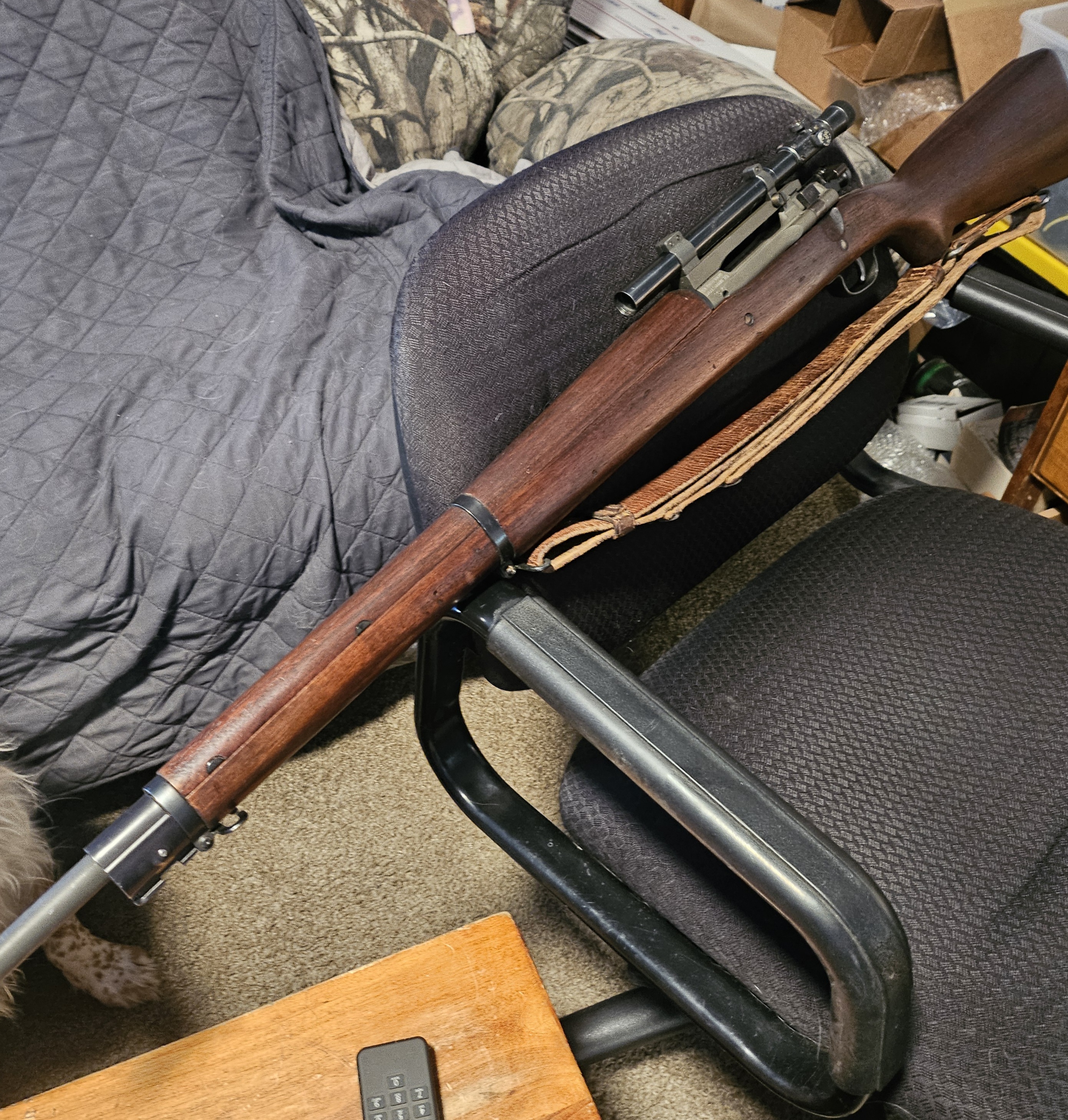

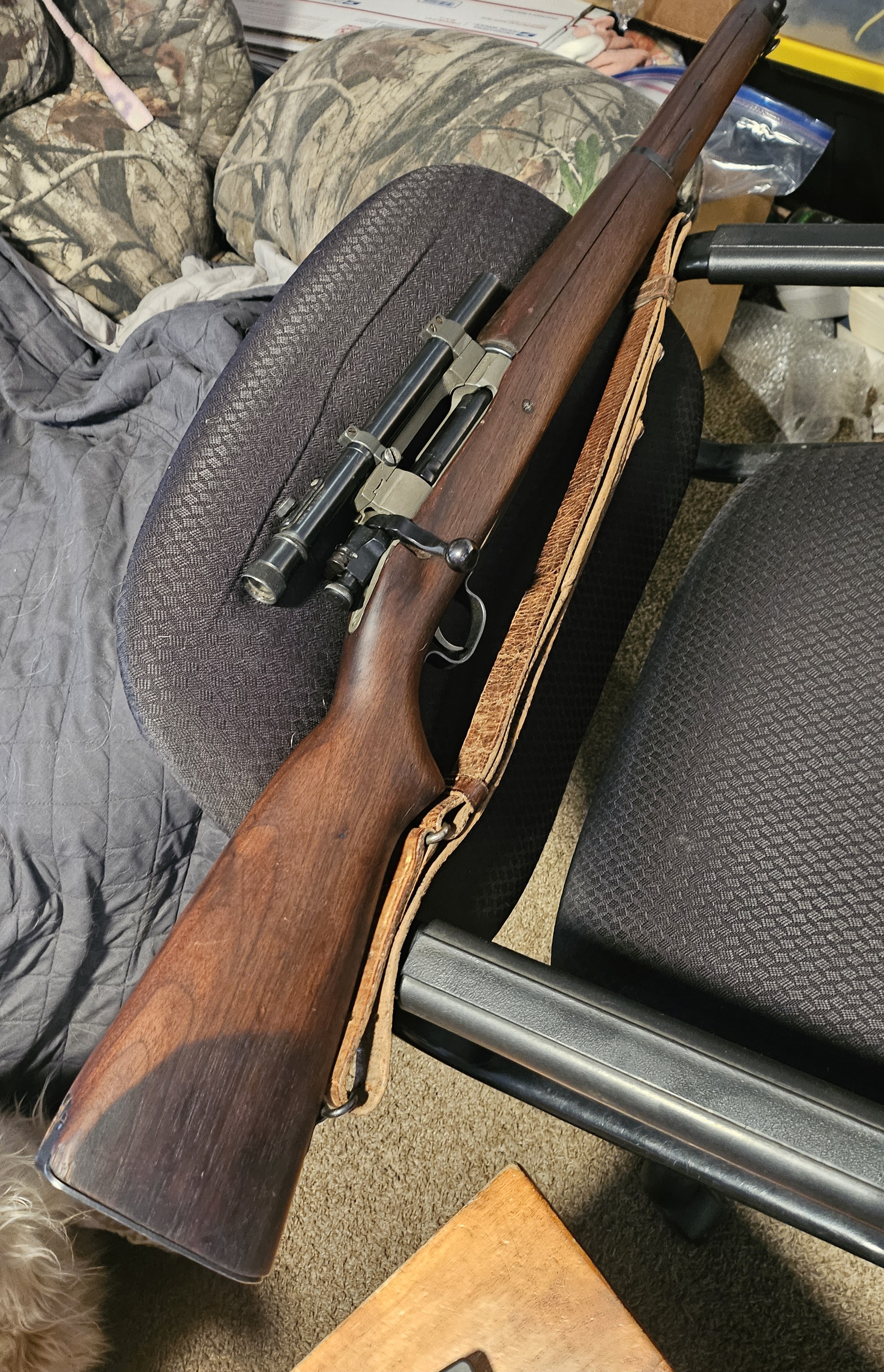

Attachment 138633Attachment 138634Attachment 138635Attachment 138636Attachment 138637Attachment 138638

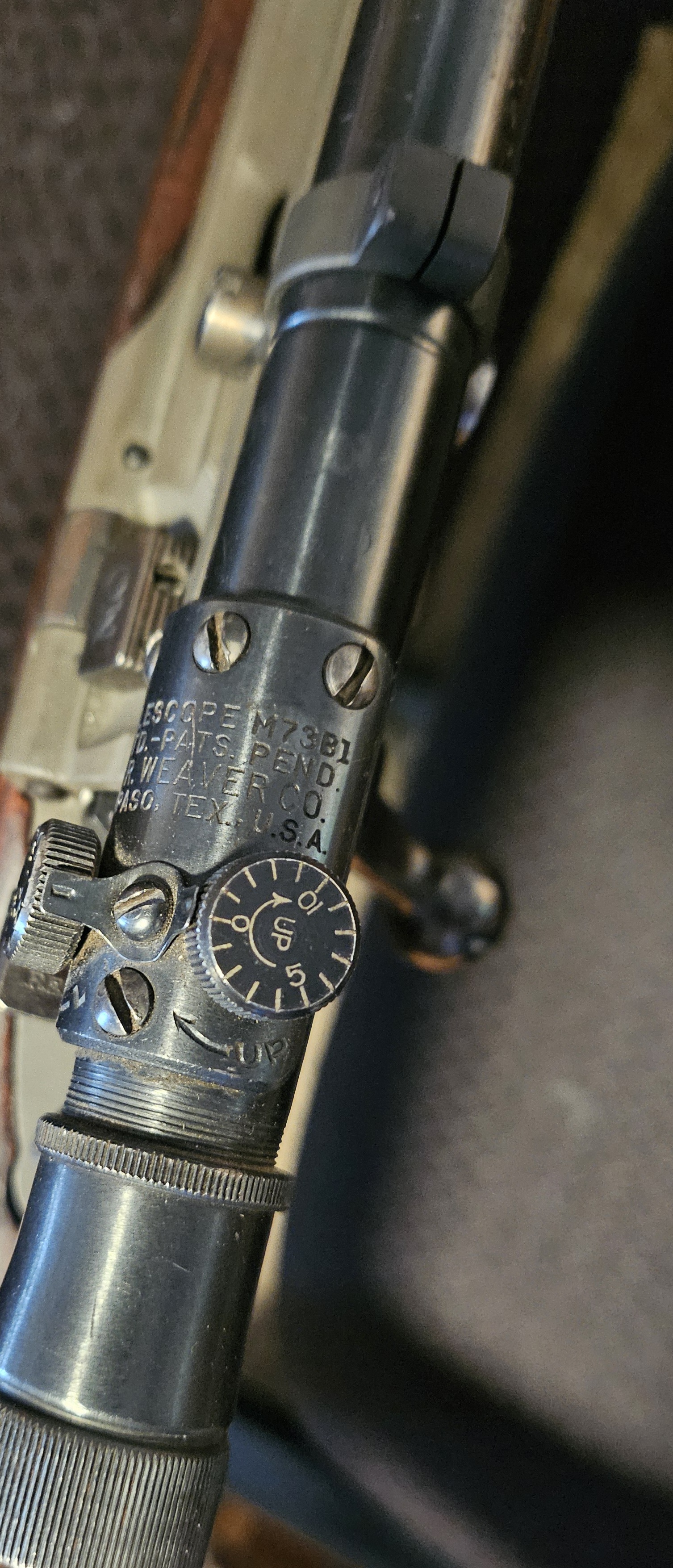

heres one of my A4s thats 75 rifles away from yours, i got it from an old lady walking it through a gunshow, had been duffle cut, said she found it under her Brothers bed after he died, and that he had it in Europe WW2, and some place i have picture of him with the rifle. its original, and correct, i reblued the bolt, as he had for some reason removed all the finish from it, the original sling was rotted off and hanging, i found one that was pretty close to the original. it has its original scope, barrel and stock, notice its marked RA FJA over SA GAW, as Springfeild provided Remington with 1100 C stocks and hand cut the bolt notch, the black spot was from a can of boot water proof can {snowseal} that had leaked onto the the rifle under the bed, when i got the rifle, the stock was so dry i looked white, the leather scope cover had got wet and as you can see rusted the scope were it was touching

Remington had no, C stocks, for the A4, Springfield sent over, 1100 C stocks from standard 1903s, just as i said, that info is posted in most of the books, the SA GAW is not a rebuild marking. it is a standard marking used at Springfield, on 1903s and M1 Garands, my rifle had never been rebuild, it was smuggled back by the troop that used it in Ww2.

Poyers has alot of misinformation. the scant grip stock wasnt used until the mid production of Z rifles, and not all were scant grip no A4s were ever built with straight stocks, by the last group, they were a mix of C and scant grip, made by 3 vendors, Keystone being only one of them American Billiard and Bowling and Milton Bradly. pre 1942 scant grip stocks were mostly sent to the USMC for 1903 rebuilds, they had no cut for a handguard ring, Clark Campbell, was a manager at Remington at the time, and was a good personal friend of mine , in his book the 03 era page 114 is goes into some detail about the stocks for the A4

1903 stocks only need to have the recoil lug area opened up, handguard ring cut, and for the A4 the bolt handle notch cut. no shaping is needed as you say. all the 1903 C Stocks Springfield provided to Remington would have a SA marking, then a FJA crossed cannon RA stamped over that, just like mine is.
